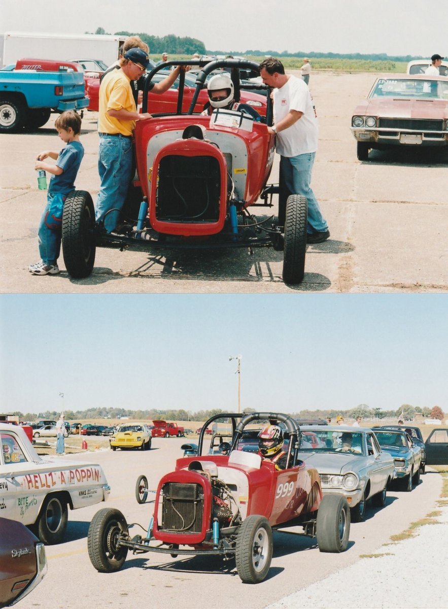

  19. christmas tree
    Joined: Dec 7, 2009
    Posts: 352
    christmas tree
    Couple pics. of the roadster, as I have ran out of things to do I,m tinkering with the heads.
