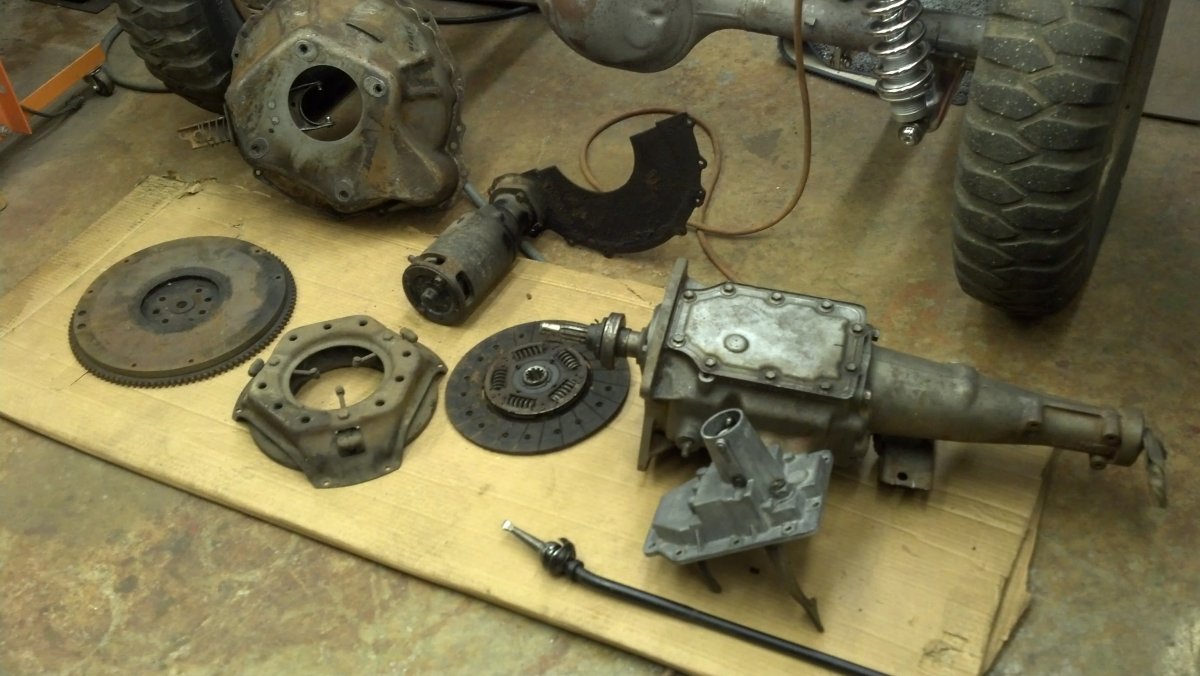

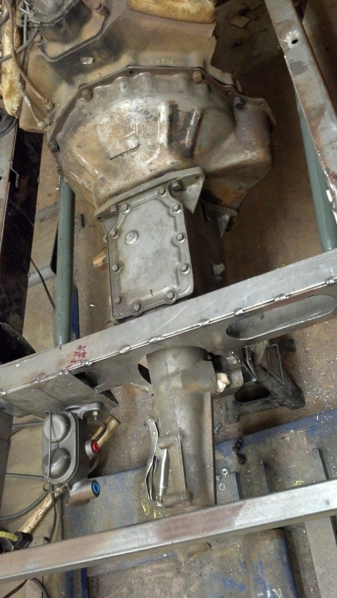

    Put a 66 Mustang top loader 4 speed into my 31 Ford Roadster behind a 1950 flathead. I also did the conversion to a Jeep T176 top loader 4 speed tower. Puts the shifter in the correct position and works well. 20191017_174304.jpg 20160417_180020.jpg

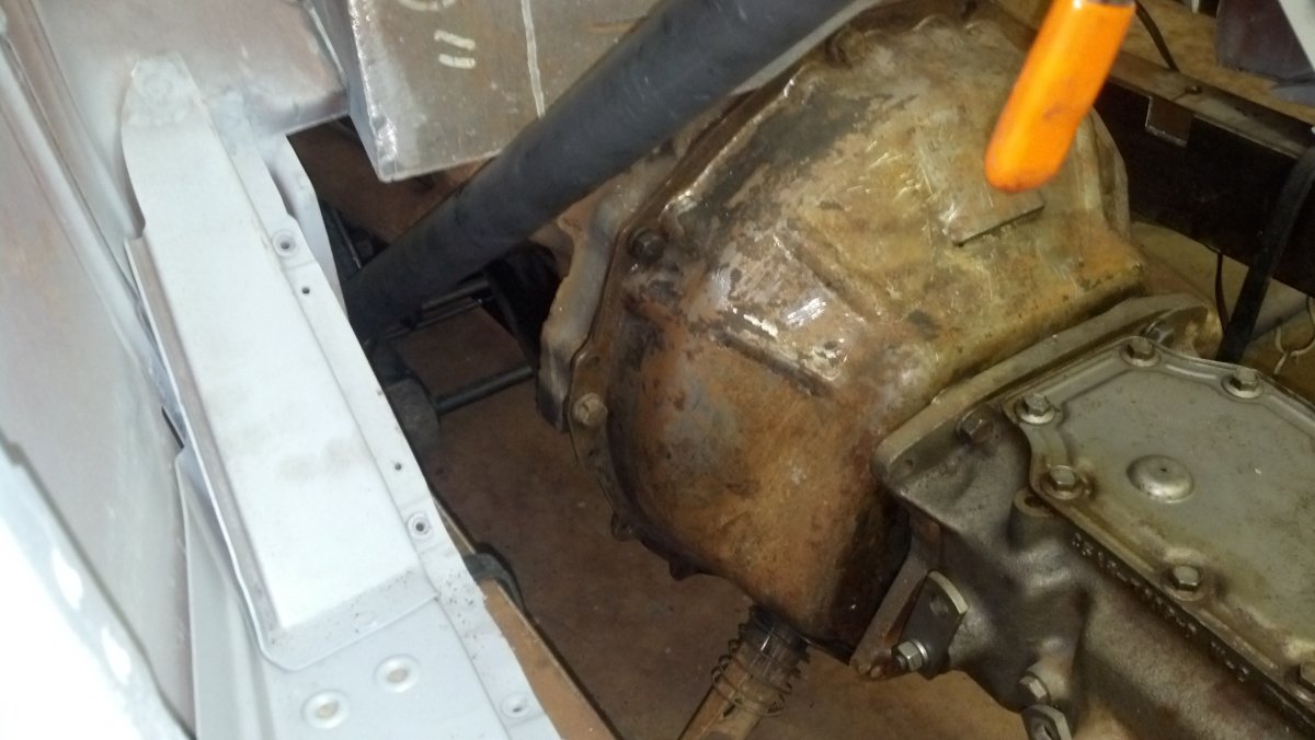

    Best I can recall it is a stamped steel bell housing from around 1950. Used the matched set of bell housing and starter plate. A sharp eyed HAMBER pointed out I had the wrong starter plate for the bell housing I was using! You can either open up the register hole for the transmission in the bell housing to match the outside diameter of the input shaft housing on the top loader or turn down the input shaft housing. There is an 1/8" difference between the two. The bell housing bolt holes match the inner ford bolt pattern on the toploader. Here are a couple better pics of the bell housing before I did the conversion on the transmission. IMG_20150629_183828_424.jpg IMG_20150629_201203_656.jpg
