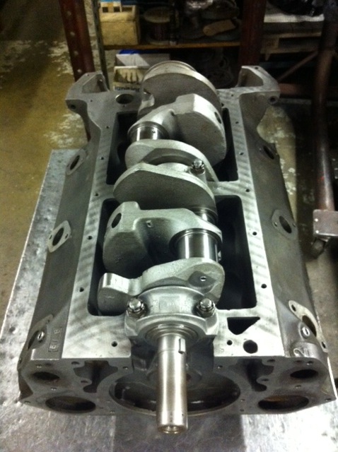

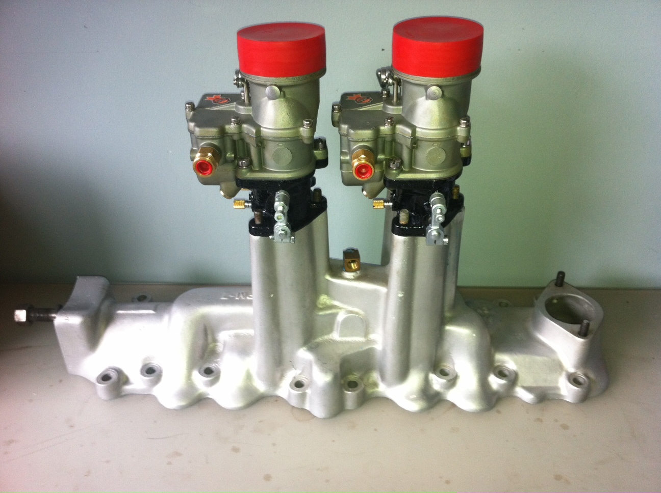

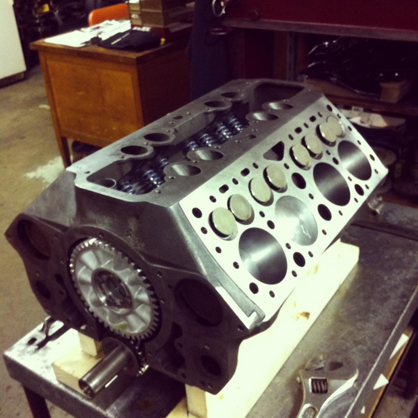

I am just building a 59A (my personal favourite flathead), purchased it as a running and complete engine. After adding the Thickstun manifold, rebuilt Stromberg 97's, Isky 1007B camshaft, N.O.S. Johnson Lifters, Mercury crankshaft, all new valvetrain, pistons, bearings, considerable machine work on block, crank, rods and heads, Skips water pumps, Bubbas distributor, 12V generator conversion, rebuilding the clutch and pressure plate, etc etc I'm probably around 7K and it is ready to fire up again. I wasn't after HP or fancy pieces but more a nice sounding, RELIABLE engine that I can drive a lot. I had a GREAT time with the project and it's not like you're spending the money in one shot, it's a gradual thing. I'd suggest buying some books before searching for an engine.
