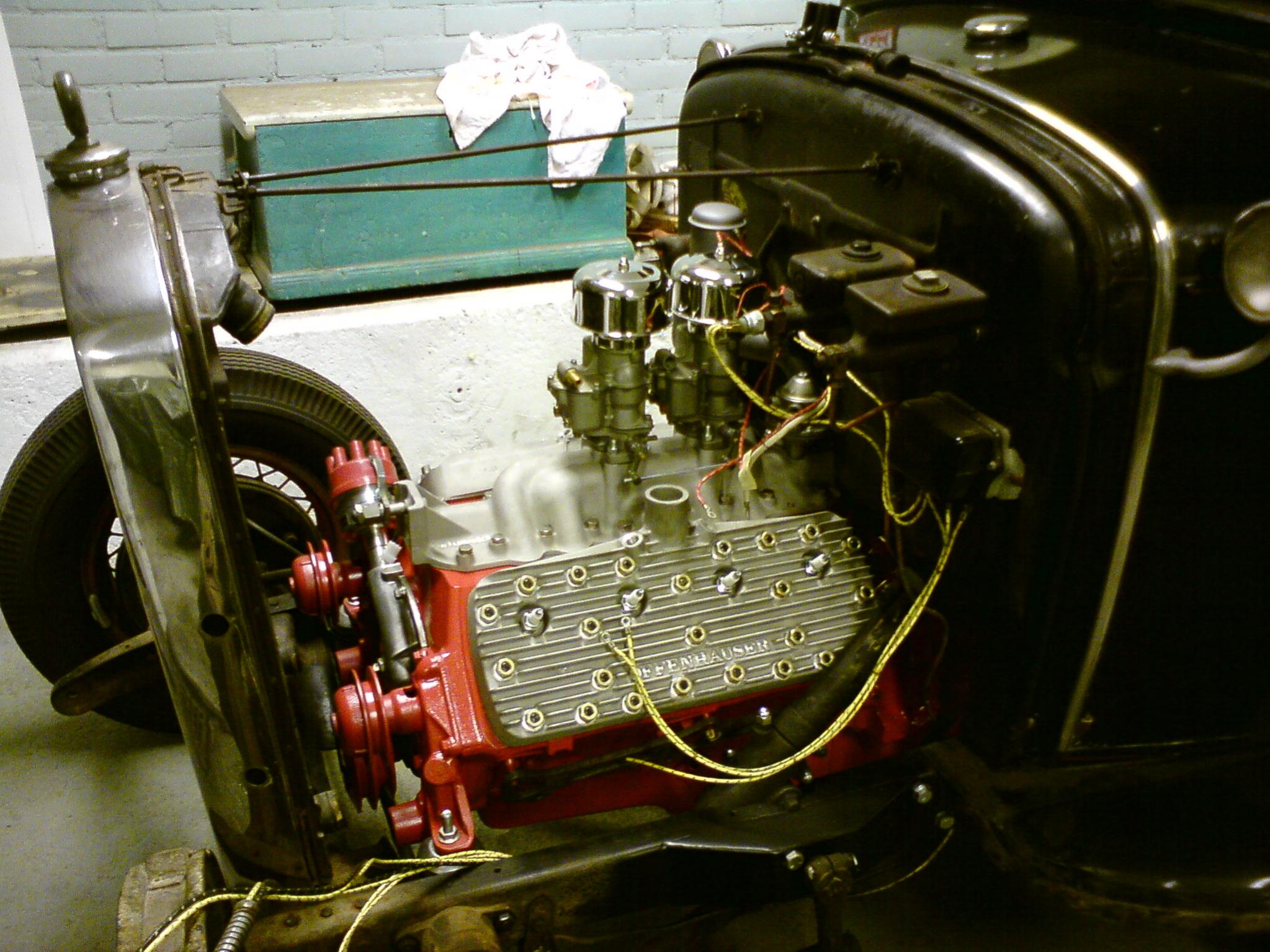

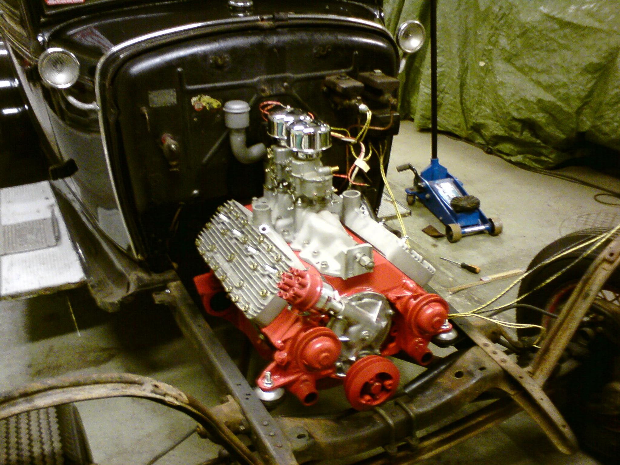

    Hello Joee, on my AV 8 did I use a 255 cui french flathead with bellhousing similar to the 59ab engine, its fits right on a -39 gearbox and the gearbox is bolted right on to the stock rearaxle with tourqetube (not shortened) I had to make room for the breathercap in the firewall and I use a stock -32 radiator, this is the easy part! the tricky part is to find room for the steeringkolumn and the pedalassembly!
    Good Luck!
