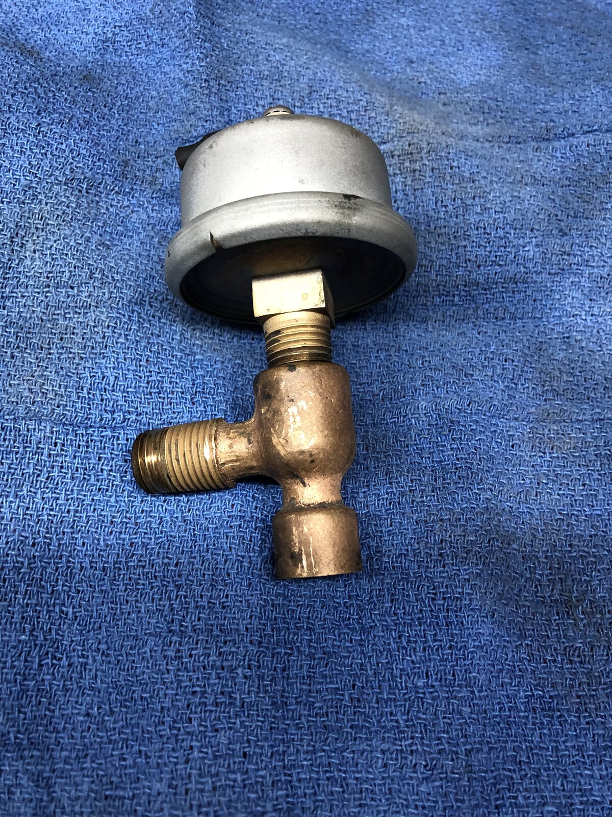

  9. A6124CFF-29FE-4FCB-946C-AE0DAB38EE7A.jpeg If you have the restriction in the outlet ,,it will make the top of the canister leak,,,,,from the pressure.
    The restriction is at the inlet,,,,,from the oil pump end ,,,,,,that is where the pressure is .
    Then the fitting lowers the pressure to a controlled rate and the filter and canister can handle the oil without blowing out .
    Here is the restriction orifice fitting from my Mercury,,,,,it is the br*** piece,,,,the oil pressure sender is in top.
    Tommy

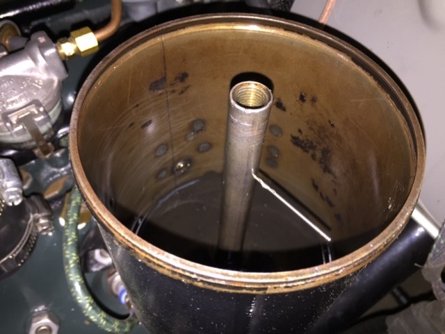

    Again, specifically for a 59ab Ford filter and not a GM or Chrysler or whatever else, there are two .055" restrictor holes on the outlet tube; one high and one low. These canisters are built to hold pressure, there is no luck involved. This may be a different situation on other makes and models but for as many Ford flathead runners that there are on this site, it is not in their best interest to follow parroted information from Google searches and blanket statements about byp*** filters in general. Ford was smart, they knew that putting such a small hole on an inlet could allow the line to be plugged thus rendering the filter useless.

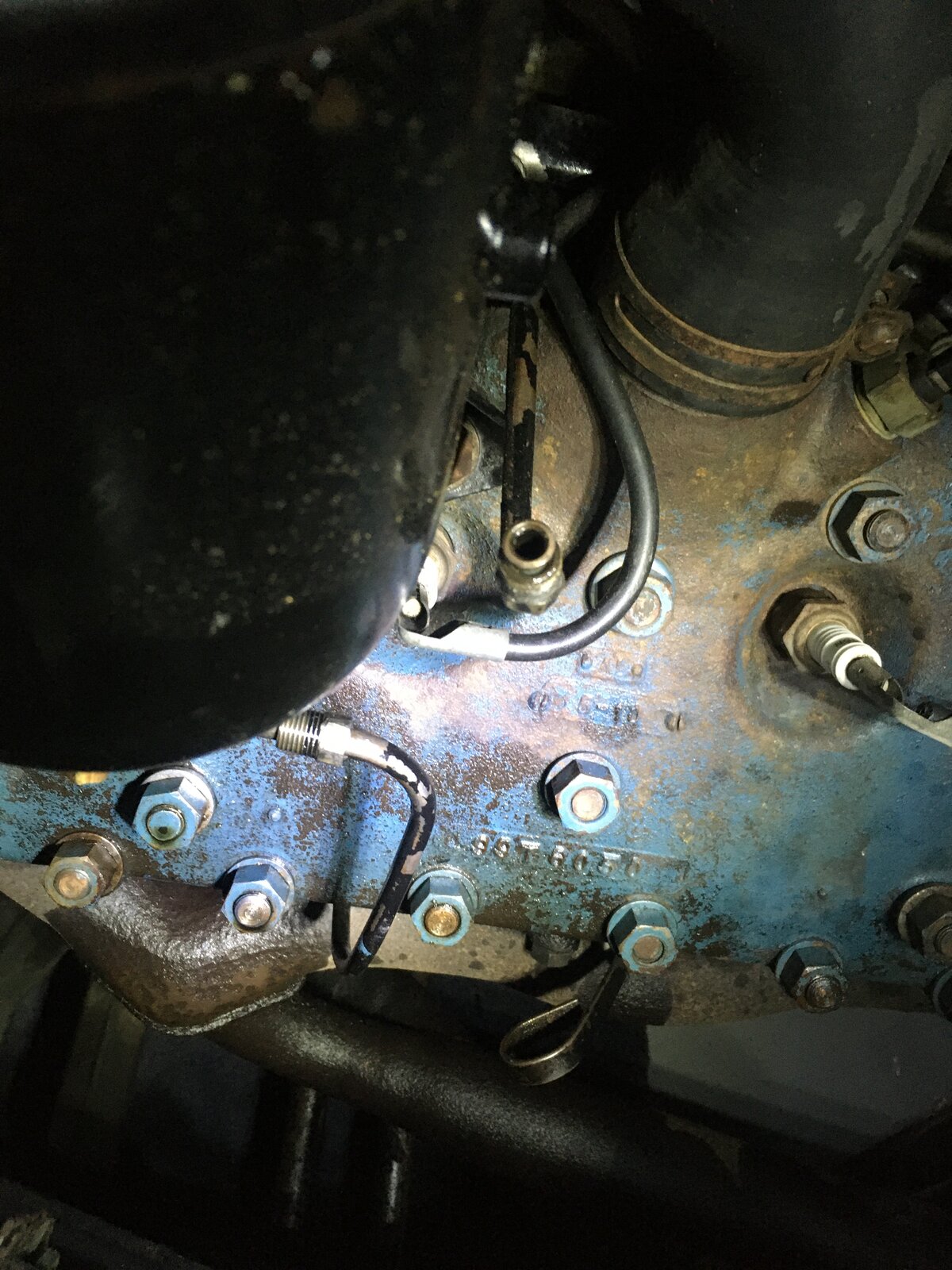

  23. I can’t speak to those ,,,,,I only have experience with the 8 BA style engine .
    My block has a boss cast into it for the return line.
    A fitting screws into the block outside,,,,and the oil drains back into the pan beside the pan rail .
    Here is a pic of my block,,,,and the return.
    And you are right,,,,the return doesn’t have a restriction.
    Tommy
