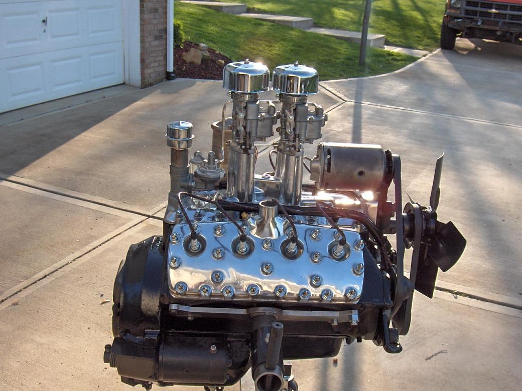

    I have a ford flathead 59a that I may have installed 8ba timing gears. I am running a 59a cam,distributer and front cover. I know the thrust direction is different. I have never fired engine do I need to tear the engine down?

    not sure, i would like to know the answer to this too. its certainly not hard to change it again if needed, front cover off,drop pan, line up gears, slide off and replace.

    for what it's worth, i wouldn't run them. it will slam the cam the wrong way and beat the hell out of it.

    I could not find the engine pics. It is it may have the correct gear in engine. I thought I had one of each gears and the one not in my engine is a 59a gear. I hate to screw up the paint to check.

    That crank gear does not just slide off. Need a pretty good puller to get it off. You do want the thrust against the block on the 59AB.

    I am running just the opposite, an 8ba with early gears, In my feable mind I didn't like how the thrust of the cam was going forward pushing on the timing cover, I would change them if I was you

    i would want the correect gears. having the thrust against the timing cover might adversly affect the distributor end play, ign and cam timing.

    I always accepted it as gospel that pre-49 needed rear thrust and post to the front, and I long ago had a distributor failure that I blamed on 8BA gears...though I had no idea how to ****yze that back then.
    Since then, Ron on the barn pointed out that normally the movement available in there is minimal and so it likely does not matter.
    Stuff: First, measure actual fore and aft play...just pop off the crab and indicate or use feeler gauge.
    Second...I recently noticed that '49 Mercs (and so probably Fords and trucks, have not looked) were made with early gears...changed midyear, book indicates late preferred, no reasons given.
    third...helical gears means forward/aft movement changes timing. Would be easy to measure on a crab, probably slight, but with initial timing set off motor you are ***uming proper gears.
    I think both setups have surfaces capable of surviving thrust either way. I would use correct gears if building anew. If I had an engine together, I would measure total movement and also be 100% sure said movement did not bottom against distributor...the thrust capacity of the distributor would fail very quickly against this.

    From what I understand, Ford designed the oil pump drive and the cam and distrib drive gear
    on 8BA engines to apply 'canceling' end play in such a way as to help keep the cam from
    exerting excessive thrust in one direction or another.
    A local here just finished building a Blown 59A and updated to the upright distributer/gears.
    The end result was a few destroyed adjustable lifters as the cam walked far enough to
    cause problems with the lifter to cam lobe. The original machinist blamed the failure on the
    adjustable lifters and installed another set and sent him on his way only to have the new
    lifters fail in the same way.
    It should also be noted that they installed a high volume oil pump which takes more umphh to turn.
    The additional power needed to turn the oil pump may have also contributed to
    upsetting the balance that the 59's stock pump and direct front (drive) mount factory
    correct dist/timing gears would normally apply.
    Our local machinist recommends checking end play on all Flatheads (59 with 8BA gears as
    well as regular 8BA builds). He prefers to use the 8BA front cover that has the 'cupped' boss
    cast into it that accepts the upright distrib cams 'extended' snout.
    (8BA 'cupped' cover on right, left is a 59A cover)
    This allows him to add a br*** shim inside the cupped boss to take up excessive end play
    and to keep excess forward thrust in check.
    There was a front cover built for 8BA powered military engines that had an adjuster bolt
    designed into the front cover. The adjuster (and shim) allowed for externally controlling the
    cams forward thrust. 'Bert' has converted both cast steel and aluminum timing covers by
    drilling a hole in alignment with the camshafts centerline and welding a nut to the outer
    cover thus allowing for the addition of an adjuster bolt similiar to the rare military 8BA front
    cover. This is also the fix that Bert performed in the case of the above mentioned blown
    engine which was brought to him after it destroyed multiple adjustable lifters.

    Thanks for the positive responses. I was sick when I realized what I may have done. I know the difference in the gears. I just mixed up my parts on ***embly. I will check the end play of the cam. If it dose not put pressure on the distributer I am running it.

    Paint is easier to replace than metal....
