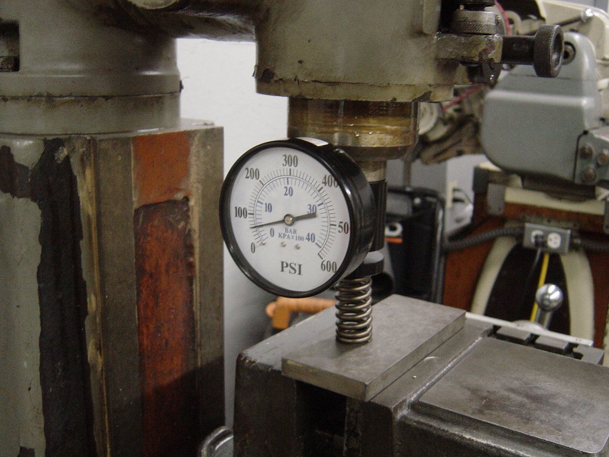

    bored and stroked set you up on the previous page with ~75lbs lots of guys run even less. stock ford valves will be about 2" installed height with no shims. you can check the spring rate on a drill press and a bathroom scale. use a long bolt and nut with a washer thread the bolt so the distance from the washer to the head of the bolt is 2". put the end of the bolt in the drill press, the spring on the bathroom scale and push the spring down with the drill press until the bolt head just touches. check the scale for pressure without shims.
  4. RevKev6 has it right --> you need to test the spring in a measuring device to figure out at what exact height, it measures the recommended/desired pounds.
    They should also, then go PAST that point and compress the spring further --- additional distance = the height of the cam profile - minus the lash + .060 . . . there should be no coil bind at that height. If there is coil bind, then this cam/valve/spring combination can't be used. With 70 - 75 lbs on the seat, you should not have a coil bind problem - unless the springs are mighty weak . . . which should not be a problem with the 185G springs or Zephyr type springs.
    Now, you know the installed height of the springs - when each valve is in the block - sitting on the seat. I usually get a couple light springs to then use during the "tuning" process. You'll find that if you just installed the valve/guide/spring/retainer/keeper package, that your installed spring length will probably be TOO long. This means you'll not have enough LBs on the seat - and you risk floating the valves!
    Given the measurement on each guide/valve/spring/retainer package - you'll need to shim the valve guide end of the spring with shims --> they normally come in .060, .030 and .015 thicknesses (and they must be the ones designed to fit the flathead guides and springs). You determine the 'shim package' needed for every valve - testing them one by one. Your goal is to get all installed valve spring heights to plus/minus about .020 or so.

    Well freezing my **** off on,the driveway today, I got the new cam in, and have 6 of the valves done, they lapped nicely with very little effort and theses valves are a lot lower in profile so....I wish I would have gotten these in the first place.
    I Did the damaged valve first and no damage to the valve seat !!!!!
    So far i needed one 0.060 shim on each valve to get 75 pounds. So 6 done and lash set.... 10 more to go on another day. Gotta load up the band equipment for a gig tonight.
