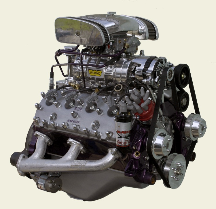

    I'm thinking about the average guy building a Flathead engine in his garage and using a local machine shop for the machine work.The usual stuff I read about here ,around 270 cubes,aftermarket heads,a coupla carbs,headers,a streetable cam and tweak this and that,about 180 or so HP? Or the same guy building a 283 SBC might wind up with 250 actual HP using bolt on parts and likely spend a lot less money.Yeah,there's one off Flathead engines build by experts where cost is no object making a lot of power.And there's turbocharged SBC's making nearly 5 hp per cubic inch.But most of us do it ourselves on a budget,yes?

    Don't get me wrong I love Flatheads but the Flathead / Chevy comparison is apples and oranges. 250 horsepower formula: Flathead - bore, stroke, port, relieve, supercharge, hot cam, multipal carbs, and cross your fingers. Chevy - turn key.
