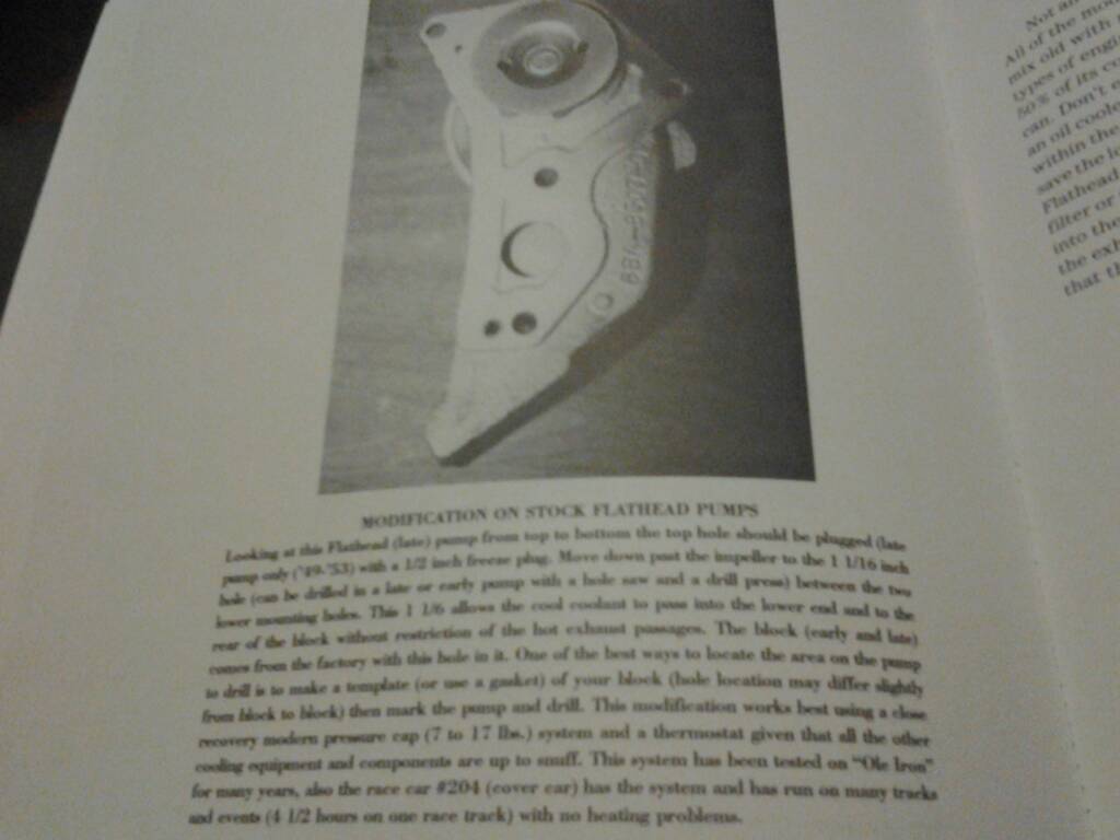

    I have been battling overheating problems on my 1950 Ford Sedan and have tried just about everything.
    I am in the process of taking it apart to replace the temp sending units and the electric fan which means emptying the coolant. And so here is the crossroad that I have reached.
    In Bill Sinclair's book, Thunder Road Flathead Guide, he talks a lot about cooling and mentions in his book a modification that he performs on the stock flathead waterpump . He drills a 1 1/16" hole below the impeller and plugs the top 1/2" hole with a freeze plug. He says it works great with a modern pressurized type system.
    Has anyone tried this modification? I am several bolts away from pulling the pumps off and trying it but is it really worth it?
    I am pretty sure the new fan is going to fix it with the minor tweaking of the engine sheetmetal to help the hot air exit but with a flathead, any extra help is a bonus.
    I am including a picture of the books picture so that you can see the modification if you don't have the book.

    Here is the picture

    If you have a flathead that doesn't overheat then congratulations. You haven't had to deal with all the frustration that comes with one that does overheat. So by telling us that you have never had a problem with yours but can tell me exactly what we need to do is kinda like a slap in the face.
    Especially when in my first post I said that I have tried just about everything. I know you are only trying to help but please read the post before offering such a generic response.

    I have the book and that pump modification is one of the few things I have doubts about. The hole is cut into the **** side of the pump allowing the pump to pull and recirculate some portion of the hot block water instead of drawing all from the radiator. I'd want a better explanation of the theory, if it does work, before trying it.
    Working on the better fan should be enough.

    I don't know why I bother but I put those washers in my old bomb to slow down flow as the water was running through the radiator so fast it wasn't exchanging the heat....look it up.
