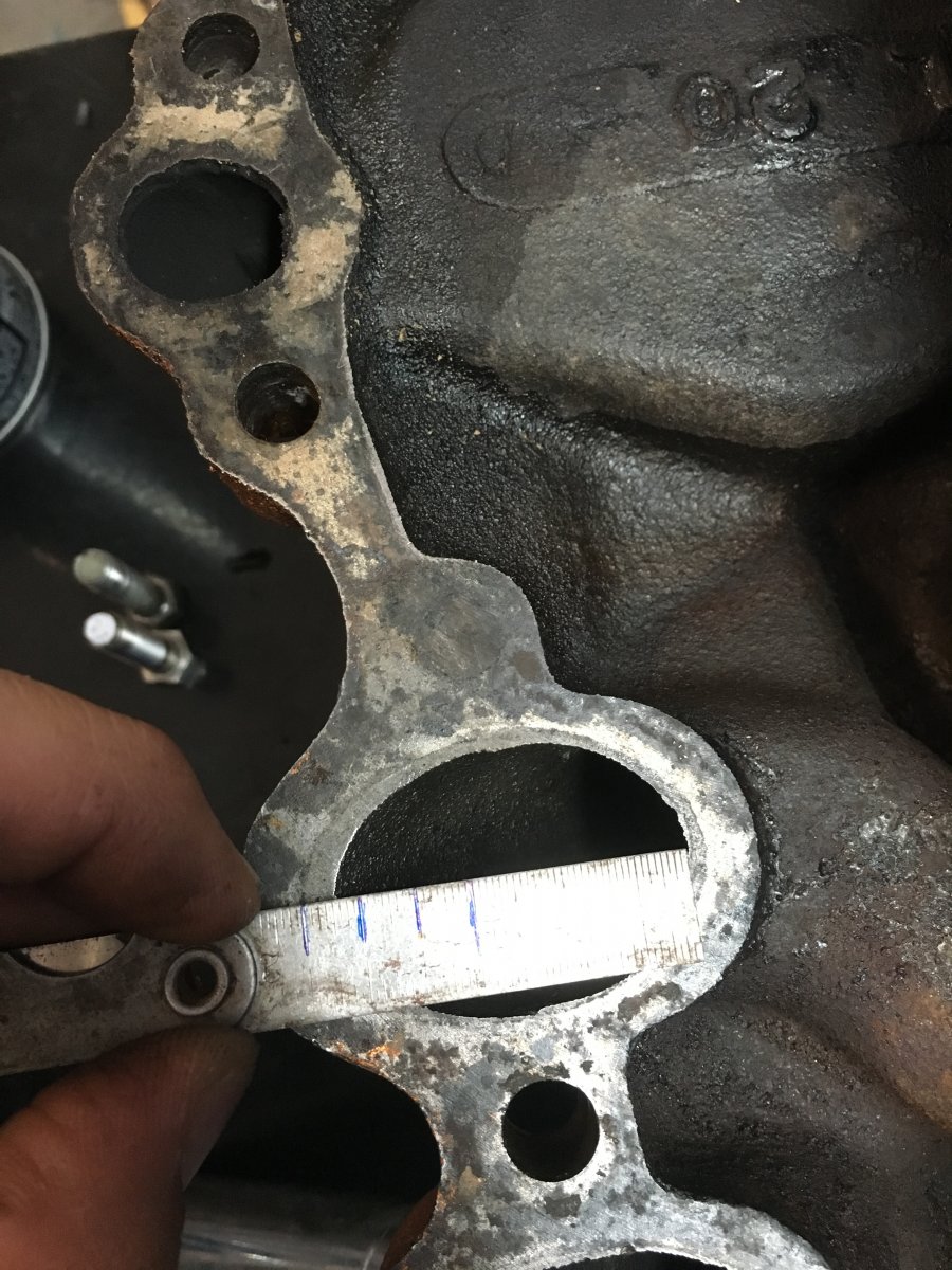

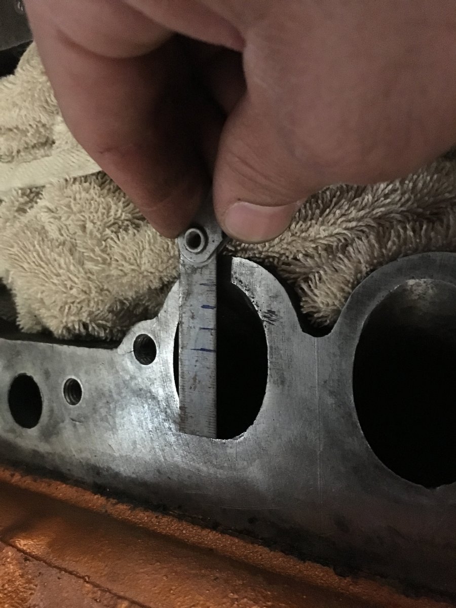

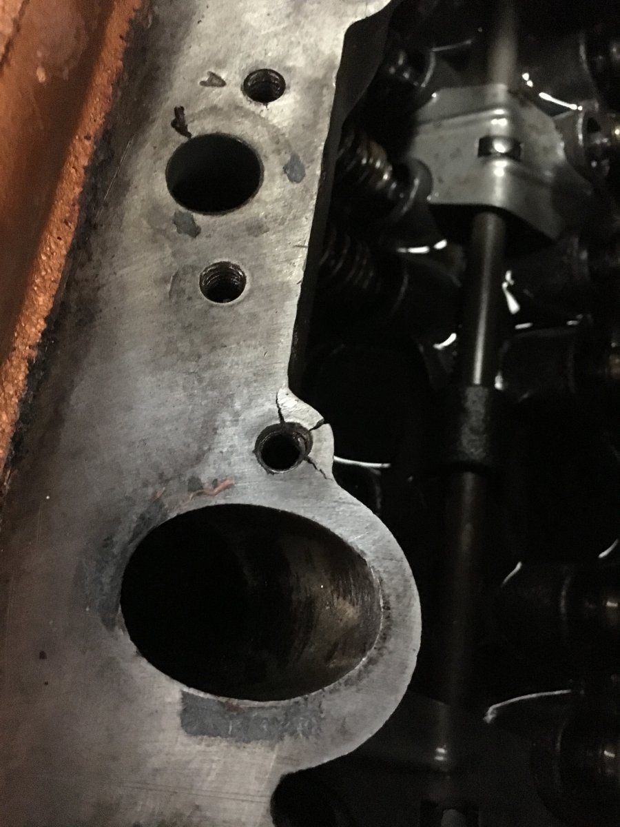

    Update 7/2/16:
    SO, I removed the manifold this morning and found a big uh-oh. The bolt that I thought was stripped had actually cracked the casting. The first picture shows what it looked like when I removed the manifold. The second picture shows what it looked like after some extremely careful persuasion with a hammer. I inspected all the bolts that I have for the intake and found that the threads on the stock bolts are in much worse shape than the stainless. The reason that I broke the hole was because I was using stock length bolts with lock washers which already pulled 1/8"-3/16" bolt out of the hole, and on the one I messed up, I also had a spark plug wire bracket on it, causing that bolt to be almost a full 1/4" further out of the hole than it should have been. My solution to the damage since there is still clean threads in the bottom half of the hole is to use a stud with a metric ****load of penetrating loc***e. I'm hoping that this will hold everything firm without requiring me to pull the motor and bring it to a machine shop. I'll be heading out to pick up some really good studs to install and also pick up some other things, shortly.
    However, I wanted to ask everyone if it looks like my block is potentially ported? The oval port, measured the long way, is about 1/4 larger than the intake manifold and it appears that it has been machined at least part of the way down. Check out the pictures and tell me what you guys think. I colored the 1/4 gradation on the ruler so it would show up on camera. I'm not entirely sure if I'm going to order a new/performance manifold or try again to reuse stock, but with the giant port mismatch, I'm thinking a performance manifold might be a good idea.
    Bonus/PS. Does anyone think it would be a good idea to drill and tap a hole in between the ports nearest the damaged hole, in order to add another intake bolt for strength? Since the aftermarket manifolds have all the holes rather than the stock which has them blanked off, I figured this might make it more likely to seal. Again, any suggestions are welcome.

    Those manifold bolts take very little torque, and the flat sealing surfaces don't normally give people trouble. I'd just put a longer bolt to get to the good threads and be done with it.

    Looks to me like someone screwed the wrong size bolt in those holes or overtorqued the hell out of them. In 25 years, I have never seen cracks like that. The fact that your bolts wouldn't hold torque, should have been a clue that you had a bad bolt or hole.

    Flatjack, the reason that hole cracked is because only half the bolt was in it. It was honestly my mistake, as I didn't account for the added thickness of the lock washer and the spark plug bracket. I have already installed a stud and will be moving forward next week when I decide what parts to order. Most like to will just run my intake again, be it this time with a tiny bit of Indian head shellac on a new Fel pro gasket.
    I will be honest though, I am quite surprised at the giant mismatch in the ports. I mean looking at the gasket that was on there, the intake manifold port is almost 1/8" smaller all the way around. I'm wondering if an aftermarket intake would have larger runners/ports?

    I don't believe that the after market manifolds have substantially larger ports if larger at all.

    Clean the hole very good then fill with JB weld & drill & tap to stock size. Not necessary to over engineer a repair.

    Someone may have done some port matching in the past. Usually the intake gasket and and intake manifold ports are compared to the intake shapes in the block . If the manifold holes are larger the block intake holes are ground to match. Probably does not net much horsepower but we do it anyway.
