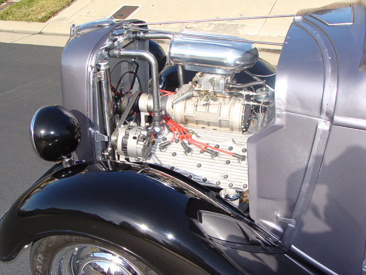

  12. Fourdy
    Joined: Dec 9, 2001
    Posts: 455
    Fourdy
    Joe Abbin all the way. I have another set and am considering building a bigger engine. Fourdy Dual View of blower motor.jpg
