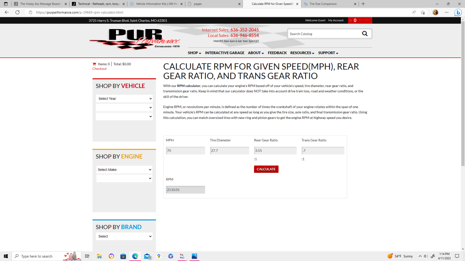

    With the 3.55 rear end, 27.7 inch tall rear tires (215-75-15 ) and .7o overdrive I shold end up with 2110 rpm at 70. If I were to run at the max torque point I would be doing between 80 thatsetup at 2411 rpm. Screenshot (1428).png Screenshot (1429).png
