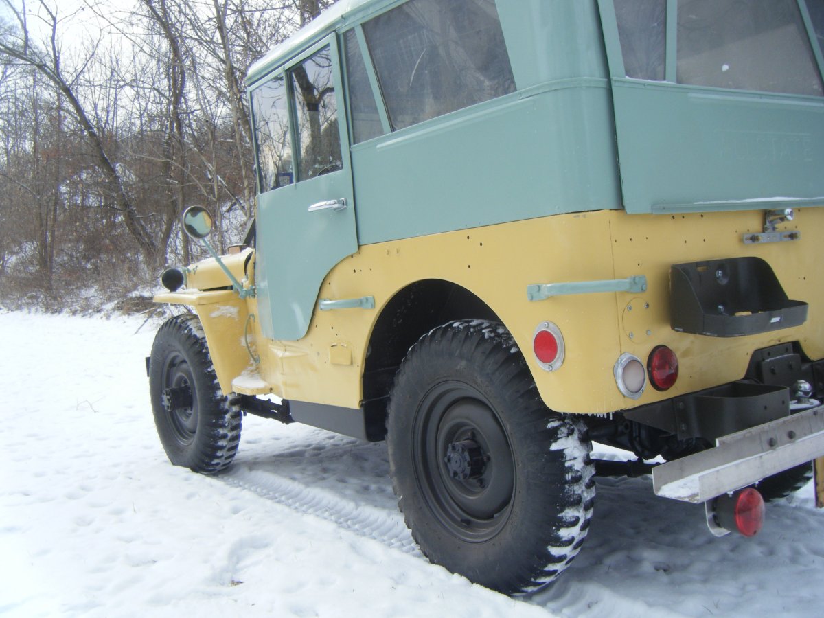

    i have sprayed benjamin moore porch and deck alkyd enamel with good results, comes in all colors and finishes.
    i recently did a 42 willys with george kirby boat paint. sprays ok and flows out nice. once dried it is surprisingly tough! they have a variety of colors. they may be able to custom mix?

  11. tb33anda3rd
    Joined: Oct 8, 2010
    Posts: 17,588
    tb33anda3rd
    fyi i did not choose the colors.

  13. tb33anda3rd
    Joined: Oct 8, 2010
    Posts: 17,588
    tb33anda3rd
    the customer's, clothing designer, girlfriend. perfect colors for a sundress:rolleyes:
