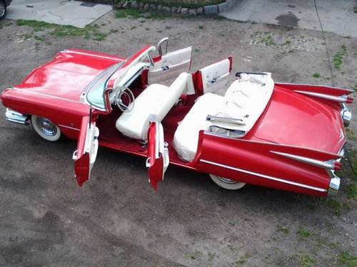

    Hey everyone. Few years ago I heard that these conversions were common in 80's. To my understanding the Frame was super Solid on these and there wasn't additional bracing needed. Whoever I heard it from said that people were using Tops from a Boat for a folding top. I have asked around for a year or so now looking for additional information about these conversions and haven't had much luck. Hoping someone here maybe able to help. I have a '59 Impala Flattop that I'm cutting Roof off of. So this would be awesome to finally find out lol. Have a great day everyone. 10868273_10204915047413380_6561960322240631059_n.jpg 2qip94g.jpg nys40j.jpg

    I've seen articles cutting the top off of hardtops and making convertible and they were supposed to have similar frames.

    That is my understanding as well. I guess the Tops didn't do much for structure that's why the used a frame similar to Verts. And I believe this fits for all GM Flattop Sedans. Not just Caddy pictured and Impala I asked about. I really think since Impala donating her Roof to another project this would be sweet to finally figure out.

    Truthfully,that looks terrible !
    I'm sure it could be accomplished and done well but again the example missed the mark! HRP

    I can only find Cadillacs with this conversion FB_IMG_1462621594253.jpg 105p4pz.jpg

    Agree and disagree. I think all Vert Tops up are not the most to look at. But for function and being pratical I would want the Top there.
