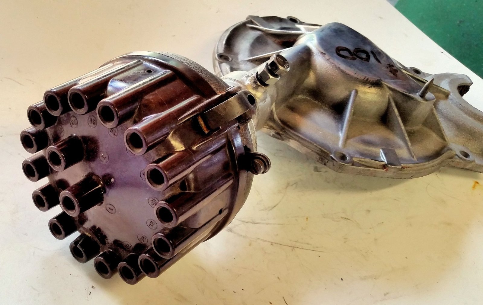

    Well I am on the lookout for a pair of Twin Plug heads. Picked up an ignition system so heads are now needed! Lol! image.jpg

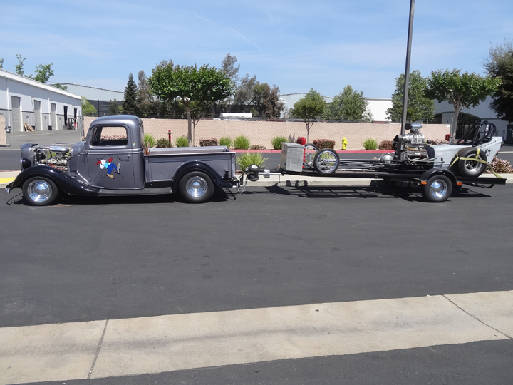

    been running this for 15 years.............5/16 x 4 in a 36P/U 9" w 3.0 gears cruises all day 75-80 at 26-2700 rpm Roadrunner setup that has been trouble free, can't say enough good things about Joe and his company, first cl*** guy.
    Oh and I use it to tow this.....
