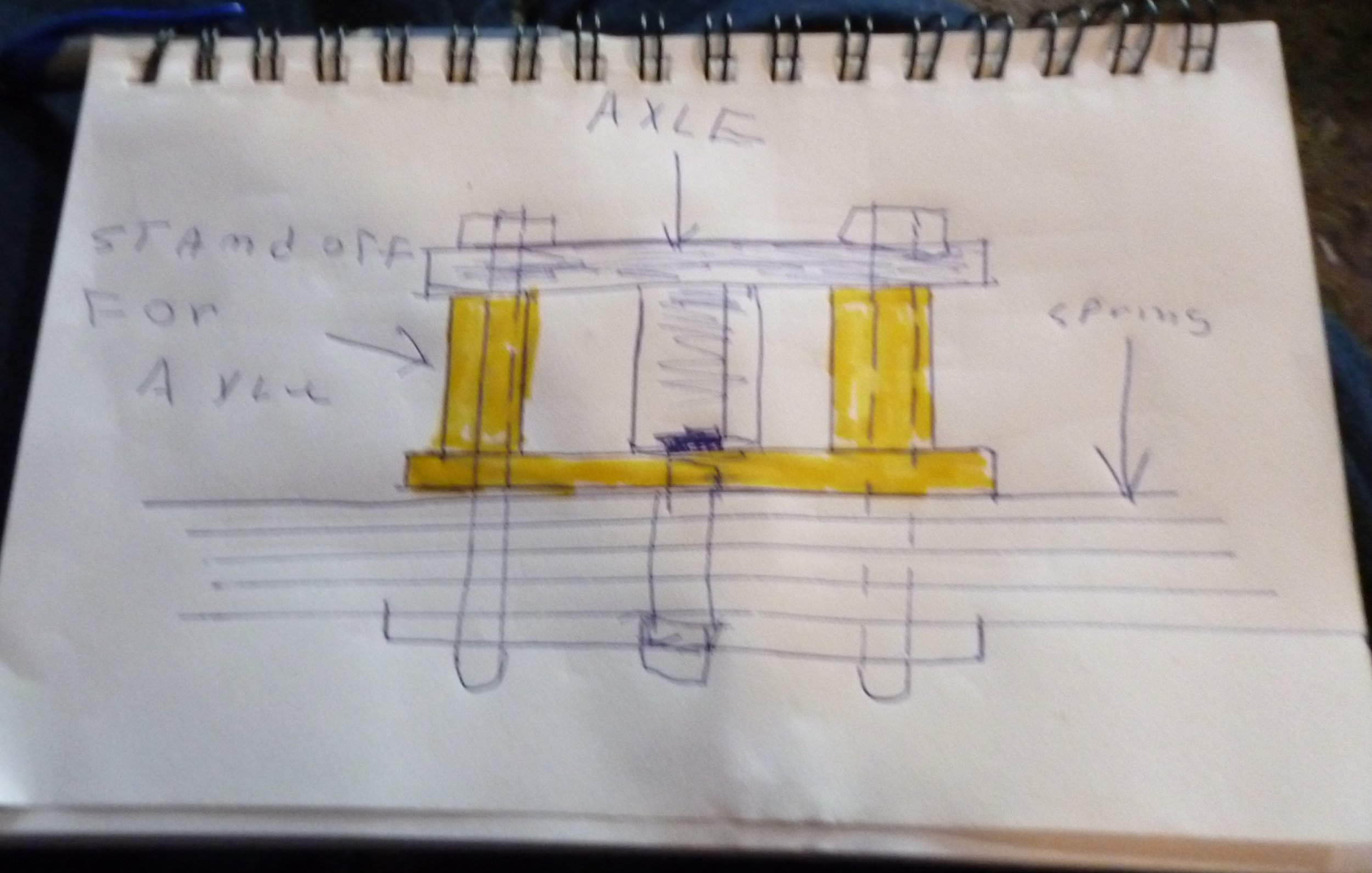

  3. Mr48chev
    Joined: Dec 28, 2007
    Posts: 35,988
    Mr48chev
    Measure the thickness of the spring where it sits on the axle and then measure down from the bottom of the axle that and a half inch or so more is going to be your scrub line.
    You will have to build a stand off or what ever you want to call it that lets you have a flat flange to sit on top of the spring and has solid pipes running up to the bottom side of the axle flange plus lets the spring bolt go through and into the hole you drill in the bottom side of the axle to locate the axle right. That means reversing the spring bolt and most likely hunting one down with a taller end on it to allow for the thickness of the metal in the standoff or base or what ever it is called plus a caster shim if needed. P1020468.JPG

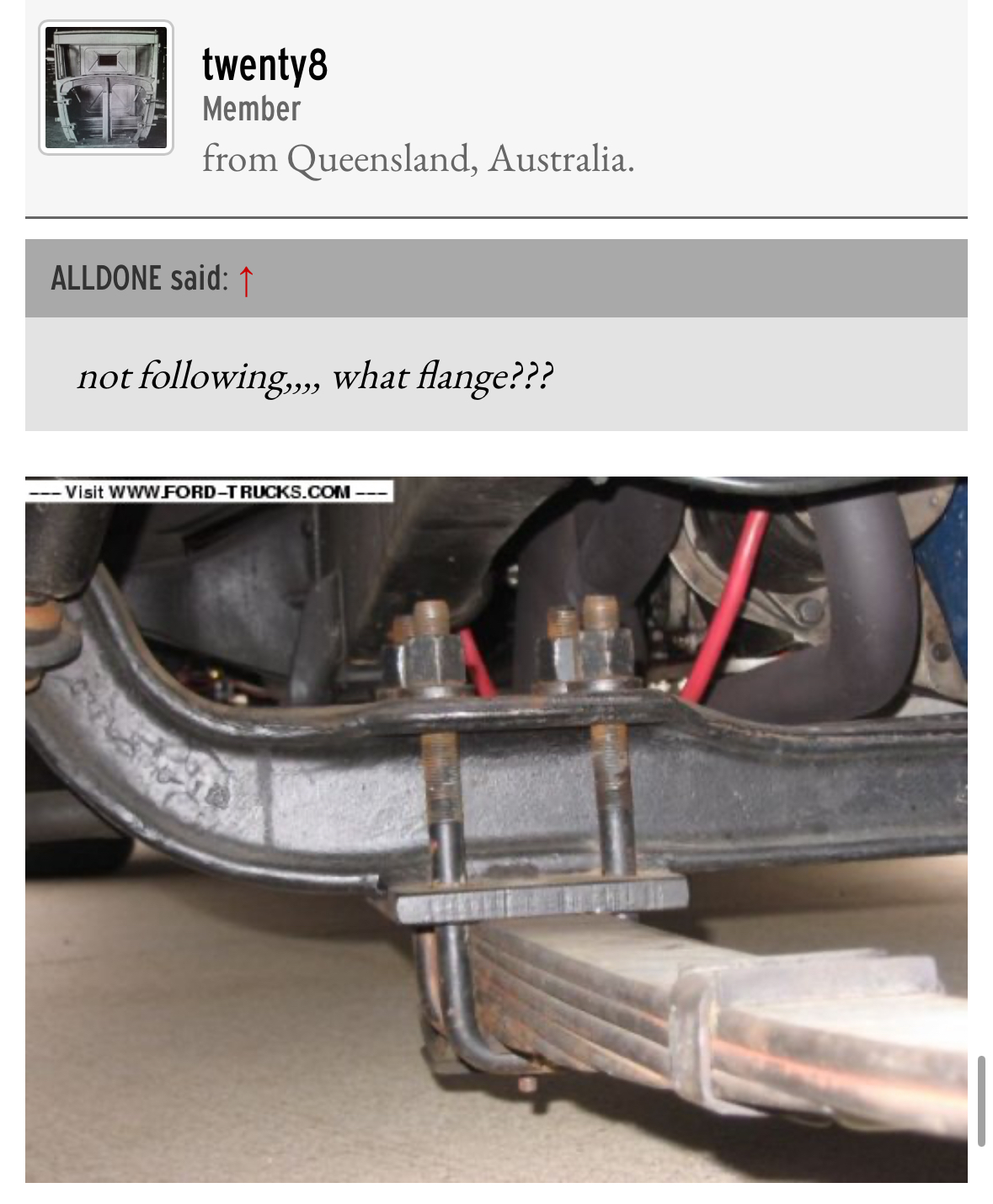

  19. GuyW
    Joined: Feb 23, 2007
    Posts: 820
    GuyW
    I think one of the flange that the spring is in contact with (1 per side) should be welded to the axle.
    Also, you could box the ends of the axle...
    ALLDONE likes this.
  20. ALLDONE
    Joined: May 16, 2023
    Posts: 3,812
    ALLDONE
    not following,,,, what flange???
  21. twenty8
    Joined: Apr 8, 2021
    Posts: 3,690
    twenty8
    GuyW likes this.
  22. GuyW
    Posts: 820
    GuyW
    The yellow highlited one in the sketch that Mr48Chev posted, and the pic above is great.
    ALLDONE and twenty8 like this.
  23. ALLDONE
    Posts: 3,812
    ALLDONE
    where would you weld it???
  24. Tim
    Joined: Mar 2, 2001
    Posts: 20,279
    Tim
    from KCMO
    If you look close you can see the new plate is welded the the axle along the edge of the bottom flange of the axle.
    GuyW, twenty8 and guthriesmith like this.

  28. ALLDONE
    Posts: 3,812
    ALLDONE
    why would you have to have a longer spring bolt if you are welding the plate to the axel??? pretty sure I got this...I'm gonna fab a saddle for the axel with a hole for the spring locating bolt.. line it up bolt it together with longer U bolts.. then weld the saddle to the axel.... sound about right??? what i will do is bolt it all together and check the caster... 5 or 6 degrees should work, right?? then I can fab the saddle with the correct amount of caster....right???
  29. Tim
    Joined: Mar 2, 2001
    Posts: 20,279
    Tim
    from KCMO
