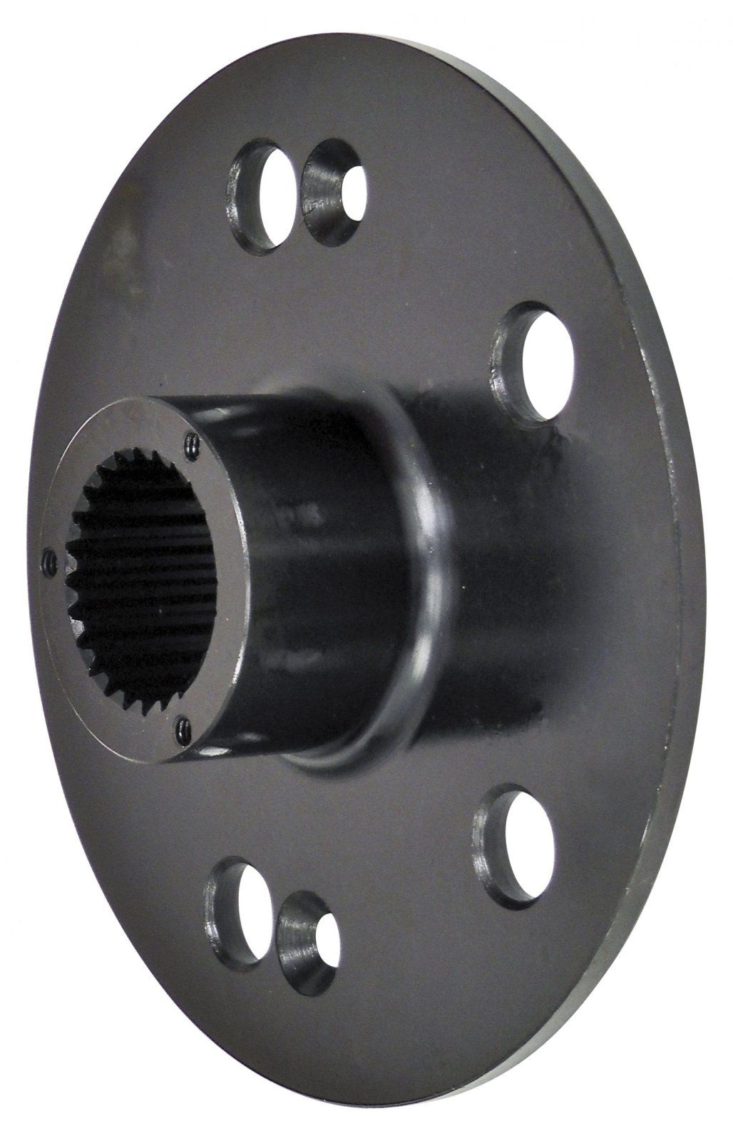

    The wheels get mounted to hubs, not to axle flanges like on a common rear axle.
    Those hubs ride on bearings that are on the axle housing tube
    They are held on by big lock nuts.
    With this configuration, the only responsibility the axle shaft has is transmitting power to a the drive flange on the hub. 100-20718-scaled.jpg
    This is how almost every truck 1-ton and bigger is configured.
    You can snap an axle, and not risk losing a wheel.
    The axle shaft can be lighter, and even gun-drilled, as it doesn't have to support the weight of the vehicle.

    In my encounters a full floating rear axle has inner and outer bearing in the hub. The wheel bolts to the hub. The axle then bolts to the hub that supports the wheel. These as I’ve worked on only have spines to go into the third member.
    So the type @gimpyshotrods shows the axle has splines on both ends?

    Yes! You got it.

    Here are the opposite ends of a pair of axle shafts
    Those are for my Model A. The 31-spline ends go into the differential.
    The other ends go into the drive flanges.
