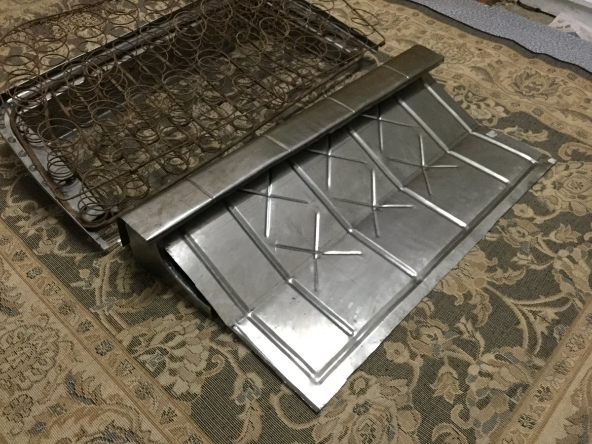

    18 gauge cold rolled steel is what I use when making up floor pans. I have been making up the entire floor and seat for a mates 29 Roadster. 5B9A970C-38DB-45AA-AA6C-E8F40871903E.jpeg 316CD3FB-6994-4072-AFD0-0B0483BA6F96.jpeg

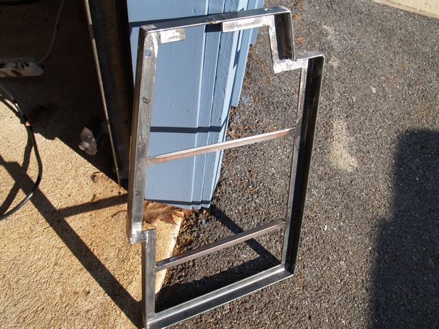

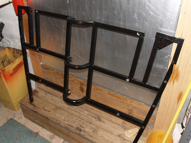

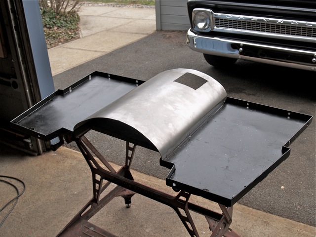

    I read the prior post on tubing overkill & as I look back at my old first build, I plead guilty as charged. I guess it added a few pounds, but there sure is no flex. Here are some bits & pieces I pulled out of the archives.
