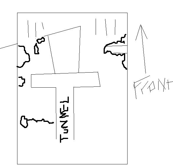

    I did a quick sketch but the bold black areas are where my holes are and there is a crack in the back, was wondering whats the best way and the most cost effictive way to do a floor board, without sheetmetal and rivets, also cannot get a welder in the garage only 110 on base.

    Theres the pic

    If this is not structural, I guess it might hold for a while. A few years ago, POR 15 had some sort of patch kit to go over rusty floors/trunks to go along with their rust paint. I do not know if they still make the kit.

    First off 110 is plenty for running a welder to do floor boards. I use a big long extension cord to reach out side on my 110 outlet and use a small portable welder with it. I've welded up to 70 amps without blowing a circuit breaker. You could go old school and braze it. The brazing rod with flux already on it is easier to use for a novice. Map gas should be able to heat up the floor enough to braze small cracks although you should really find out why it cracked in the first place. An oxy-acetylene torch would be better for brazing.

  6. "Best" and "cheap" is an oxymoron. The best way is to replace the floors with sheetmetal from PlyDo, which involves welding. The cheapest way is....well, I dont wanna go there. Unfortunately there is not much in between. If you're REALLY stuck, make up some sheetmetal patches and pop rivet them in (shudder.... I cant believe I'm saying that). That'll keep the wet out for a while, but it's neither safe nor permanent.
