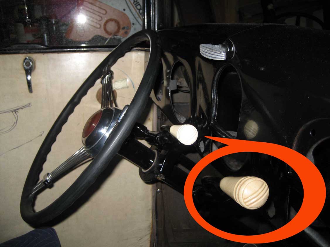

    I'm using a 48 Ford column to shift my turbo 350. I simply used one of the column shift arms and a rod to the transmission. I may add an indicator and additional detents later. It frees up a lot of floor space.

    I used the Lokar rod deal with my limeworks column. I adapted a mid fifties ford p/u column shift to this. I had to bend the rod to clear things underneath, but it works real nice.
