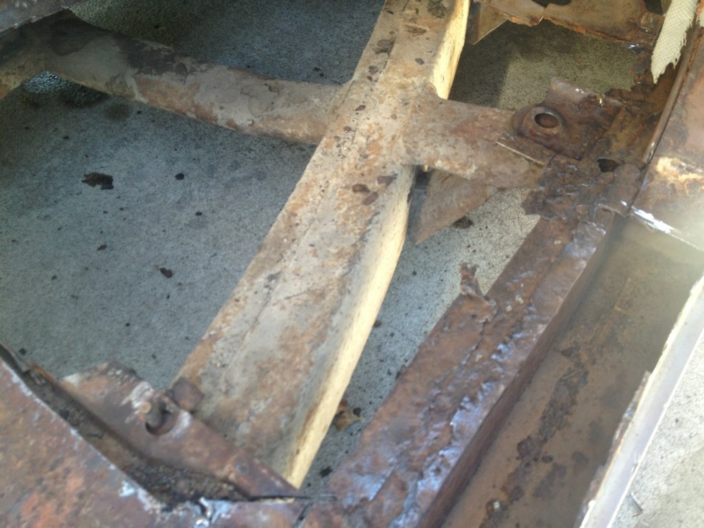

    I'm setting about fixing the hack job the previous owners did on this car -and have cut our the home made diamond plate floorpans they attempted to weld in.
    It looks like they cut out part of the cross brace, just under the front seat, one of the forward body mounts.
    There's also a ton of rust - right along the top of the rockers.
    This is my first experience -so not sure if what I'm dealing with is normal'ish.
    How bad does this look from the perspective of an experience hamb'er?
    Thanks much!

  3. Well from where I sit is about as ugly as a baboons butt.
    You will need to replace the seat support even if you buy all new floor boards for it. And a picture would help as well. What you are repairing is common if that is what you want to know.
    Don't look too bad now that you posted pics. you can post tme in the original ppst though and not have anything show up until you hit submit.

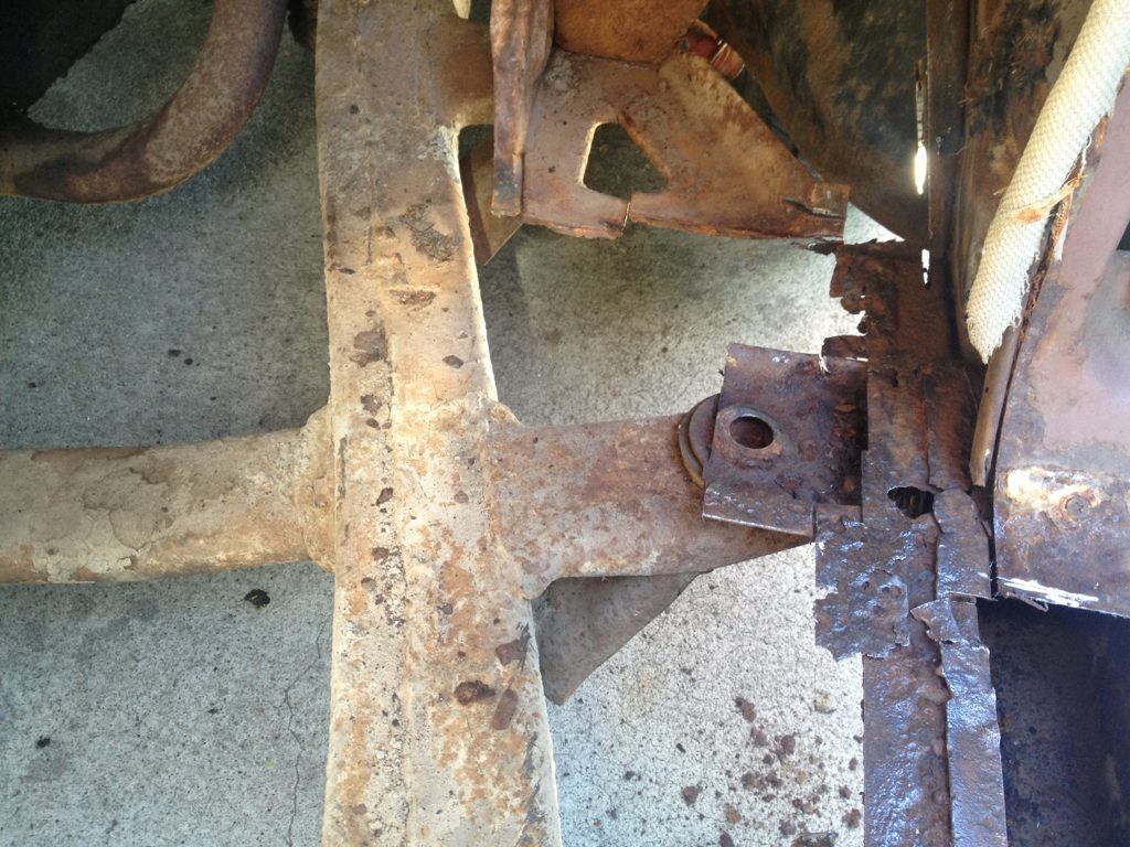

    I'm totally 100% new to this, and just not sure if i should tackle it - or pay someone.
    Not sure if any of this is really structural or not.
    If you look close, you can see where the flange coming off the seat support is cut off. There are small cuts in the forward body mount - and the body mount just in front of the kick plates is not attached to anything at the bottom.
    Do I need to build these up?
    I have new floor pans and kicks plates that are pretty darn thick. I was thinking about leaving a lot of material on, under the seats - and creating about a 1' overlap.
    Also thinking about creating some angled peices on the right hand side, foot well - just to thicken everything up - and provide more material support.
    Ideas are welcome!
  5. I edited, maybe someone else will learn from it.

  7. Let me take a wild guess the your working on a 57-58 Ford. If so then that's pretty standard Body Rott for them. Being you have no bracing and the Cowell looks to just be hanging it's real easy to build in a large issue. You might want to think about Door Fit prior to just welding things up.

  9. The Cowell is normally supported by what's rusted away. Your A pillar is part of that. The Door hangs on it. If you weld sheet metal in to patch your Large hole without this in proper place the Large Issue you'll have a good shot of building in is that getting proper Door alignment and also front fender fit may not be so easy. I guess it's possible the photos don't show everything but what I see shows me a good chance at a not so good final product.

    Cool thanks. The body mounts are not completely cut through, but they do have small cuts in them and that is my concern. I'm thinking I can add material to make them stronger, but since I am new to welding this kind of concerns me. I'll post close-up pictures later.
  11. You may want to check out E.M.S. for some patch pieces. They are not exact but with a little help can make your project a lot easier. Door fit is a must in my book prior to welding anything solid. Some inside bracing helps a Ton.
