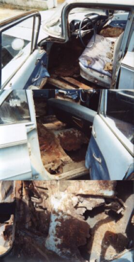

    I have some before and after shots of what I've been doing on the Brookwood. As you can see the original floor was cheese.The rockers and frame were in about the same shape. I had access to a 1985 caprice wagon floor and frame for free so it seemed like the choice was clear.I made up new sills and had the rockers bent at a sheet metal shop because my brake is too short to make them in one piece.I had to make a splice in the floor as the Brookwood is 3 inches longer wheelbase than the Caprice. I spliced the frame also.I also pieced the floor around the perimeter to attach it to the sills. It's all coming together slowly ,but progress is being made.

    Sheeit, that looks like it was a real mother f'r of a job. Nice work - came out real clean!
    Have you checked the doors for fit since ?

    Cleatus...I checked door fit and it looks good.I only set them in place but the gaps look good.I braced and cross braced the body before I took it off, and left the braces on until everything was tacked together.
