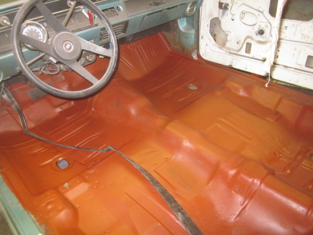

    Rustoleum and seam seal has been my choice for years. In a few cases where there was some rust I could not completely clean I have used POR-15. My finish coat is still with the reasonably priced Rustoleum. They make a rusty metal primer and the red oxide coatings that I prefer.
    Recently saw a floor (not the one in my picture) on a car I built many years ago and the Rustoleum coating still looked good.
