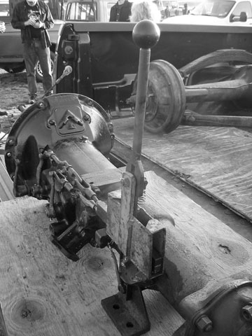

    This is a Lincoln trans, but I believe it's what you're inquiring about. I didn't build it, just saw it a swap meet and thought it was pretty damn cool. if someone couold explain how to do it, it'd be a pretty good tech article.

    looks like a cobbled together bunch of junk.
    the adjustment in the rods is acomplished by turning the welded turnbuckles.
    the shifter is meant to work in first and second by throwing the stick forward and back in the up position and third and reverse would be had by pushing down on the shifter and throwing the stick forward and back.
