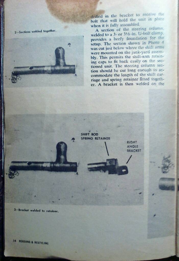

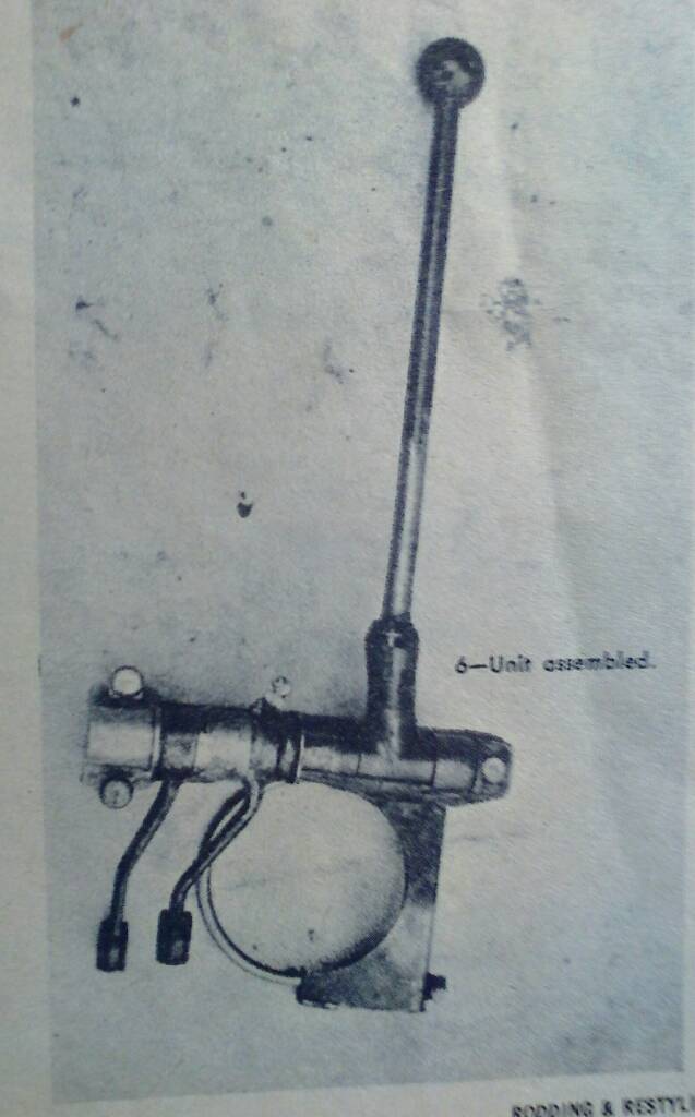

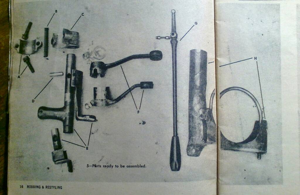

  9. rudestude
    Joined: Mar 23, 2016
    Posts: 3,048
    rudestude

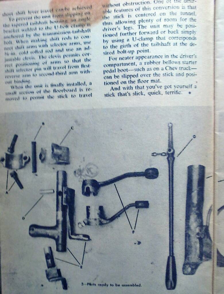

    Found the Rodding and Re-styling March 1960 vol. 7 No.1
    These pics are of the article hopefully this helps....[​IMG][​IMG][​IMG][​IMG][​IMG][​IMG][​IMG][​IMG][​IMG]

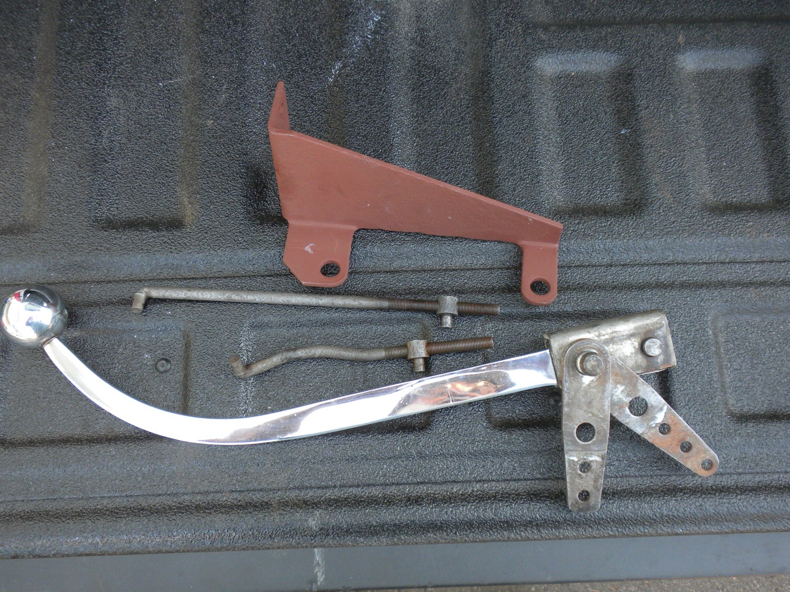

    I have this if interested came off a 53 Studebaker 3 speed 50 bucks and shipping DSCN1473.JPG
