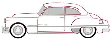

    For a creative teenager trying to solve several problems at once, it took time, but the results were so good that we could have started a item offered for sale and made money off of it. The first time we wanted a floor shifter for an automatic transmission, it became a project approved by the metal shop teacher. I had already finished my cl*** requirements and now was on the custom project track. So, I drew up what I thought was a simple lever version. But, the teacher told me to bring in a transmission if possible and start from scratch.
    upload_2025-5-3_4-30-25.png 1951 Pontiac two door sedan
    This was the goal, scallops, lowered rake, mags, and a tall shifter lever.
