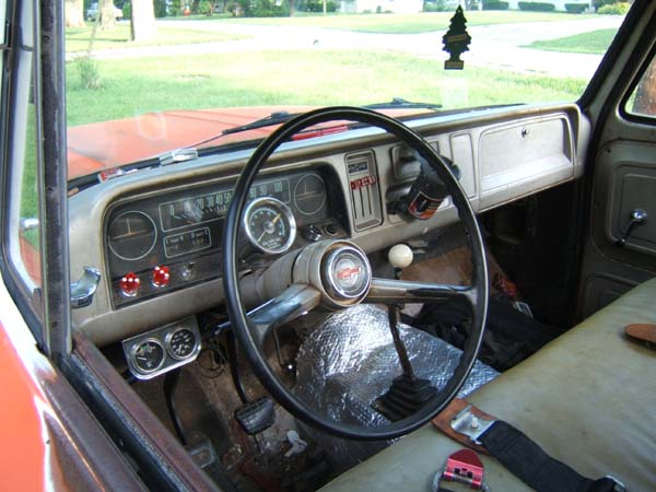

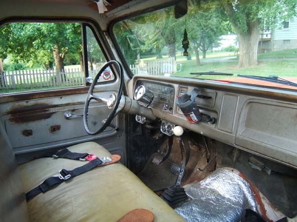

    Here's the B&M "Unimatic" in my COE - been there over 20 years.... Did just replace the cable. Summit carries the shifter and parts.
