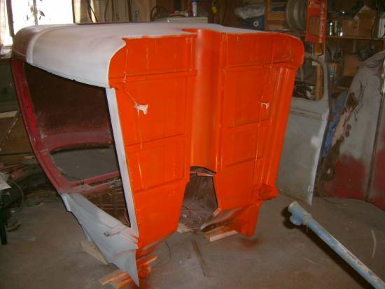

  5. Belchfire8
    Joined: Sep 18, 2005
    Posts: 1,540
    Belchfire8
    I used 1X1X1/8" and 1X2X1/8" Tube for this cab. The driveshaft tunnel is about 18ga. rolled with flanges on the bottom that the floor is weled to. The floor is heavy ga. with bead rolled into it. The thing is very strong, no "oil canning"
