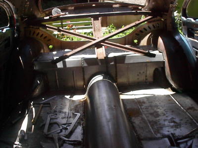

    I used 20 GA on the floor for my car but it has alot of bead rolls and under floor braces that run from rocker to rocker and then are connected together. I also used some strap steel 1"-3" and bent to fit the form under the floor and welded it to the bottom to help the floor from flexing. The body of the car is on four jackstands right now and is very stiff. It will lift one corner of the car off the stand if the stand next to it is only slightly higher. The center hump is also fully rounded and ads alot of strength.

    back seat area

    Hey dirty here is the pic I told you I would post for you to see. Fastcat

    Man that is sweet. Great looking work. I hope mine goes that easy.
