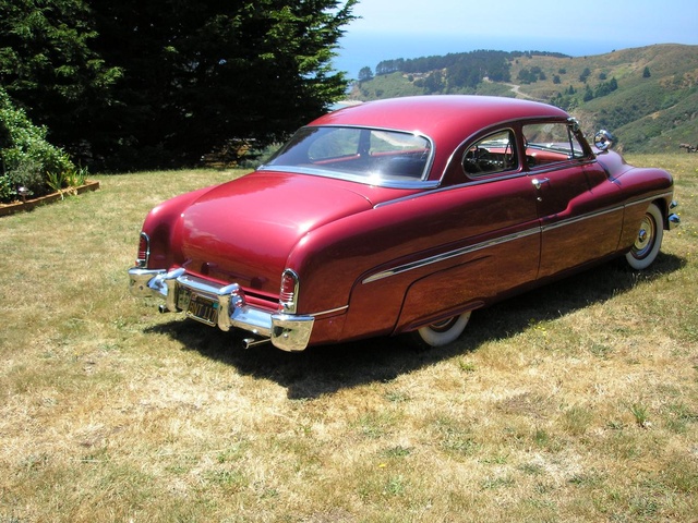

    These three shots should show the difference between a flush mount skirt on a 51 Merc built by Paul Harper and the stock skirts on a stock 51 that lay on top of the side of the fender.
    On MsMerc I think Paul said he cut the fender out and recessed the metal that is normally behind the skirt to flush mount it. It just makes the car that much smoother down the side.
    Sorry about the dark photos as I took those two on an overcast day at Vantage at the East/West flathead run a few years ago and snagged the photo of the red stock one off the net. MS Merc rear quarter.jpg MS Merc side.jpg 1951_mercury_monterey-pic-23640547842872712-640x480.jpeg

    Thank you, Mr48, that does help immensely. I kind of figured that was the case. I think what confused me was reading a thread regarding cutting some skirts to fit "flush with a flare" on another thread here. I wasn't sure how they could be both.
