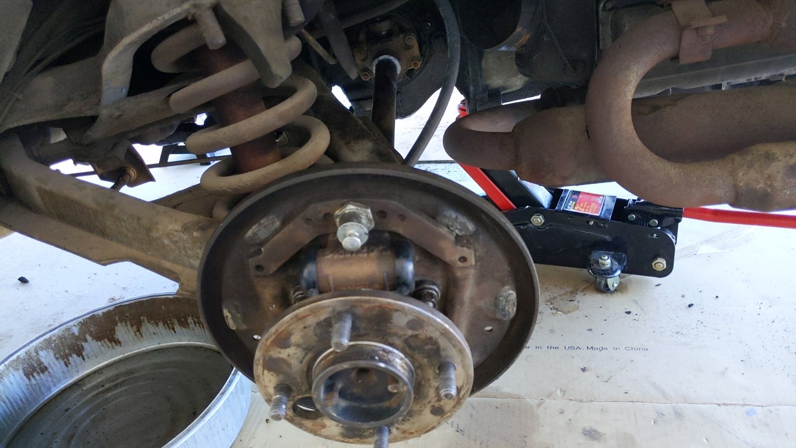

    My son has not yet made it down here, so I've been wrenching on this thing by myself so far.
    My dad left behind a couple of pretty rough vintage tin projects that he had big plans for at one time, a dozen corvairs, and some late model stuff like Vegas.
    PXL_20211011_154044468.jpg PXL_20211011_154218219.jpg PXL_20211011_154156199.jpg .

    I couldn't get the rear wheel bearings apart to grease them. It is a pair of ball bearings that allow for angular misalignment in a cast iron housing, everything is pressed together. I don't trust 60-year-old grease, so I drilled a hole between the bearing races and put in a zerk fitting, and pumped in new red grease until all the old black grease stopped flowing out. That should work I'm going to put the axles back in the car and run it for a while without the brakes yet installed so that it will sling out any excess and it will get on the brakes. PXL_20211009_191300062.jpg PXL_20211009_191833491.jpg

    Squirrel, I like to learn from other people's problems and / or mistakes even better than I like learning from personal experience. Your wheel bearing problem in the wedge was an education for me that I am applying to the Corvair. I spent a whole day trying to get that bearing off of there, because I was determined to lubricate it. But when I couldn't get it off without destroying it, I decided to try the grease fitting thing.

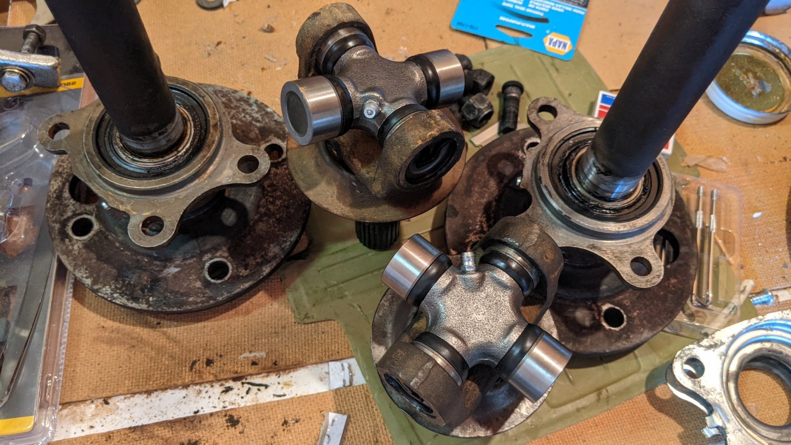

    I have the wheel cylinders rebuilt, bearings are packed, new rubber hoses for the brakes, and everything is getting switched over to dot five fluid.
    The old axle u-joints did not have grease fittings and the grease in them was all dried out and stiff. I dis***embled them to grease them up, but that was a bad idea. Little needles were everywhere except where they needed to be so I decided to spring for new u-joints as well.
    Working on my dad's car, at his place, with his tools, I'm thinking of him almost constantly. It's good for my spirit. It makes me not feel sad as much.

    The wheel bearings don't really need much, just a few squirts of grease through a hole drilled in them. They'll be fine now.
    Bring a spare fan bearing, starter, and generator, as well as the "normal" things.

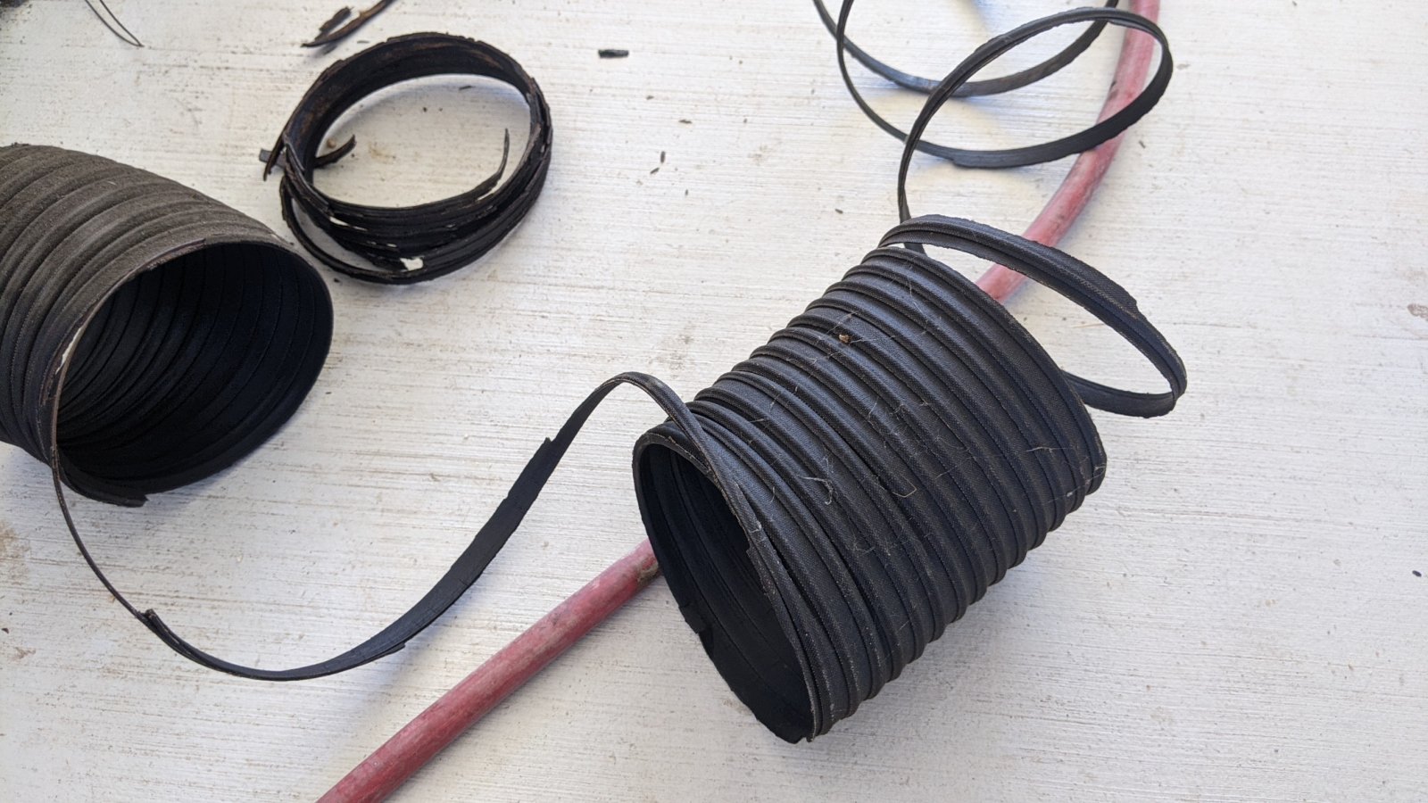

    I got the left axle, u joint, and brake line in. I had to remove the heater duct to get at the upper brake hose bracket. It literally fell apart. Does anybody know where I can get some of this stuff in short order? It's 4 inch.

    dryer vent duct, but gotta be careful about not letting it short the battery cable at the starter
    use duct tape as needed :)

    The heater “hose” looks like the same stuff used in VWs. I’ll see if I can get an accurate diameter measurement for you.
    Back in a bit.
    Edit: The ‘67 Bug I have uses 2inch.
