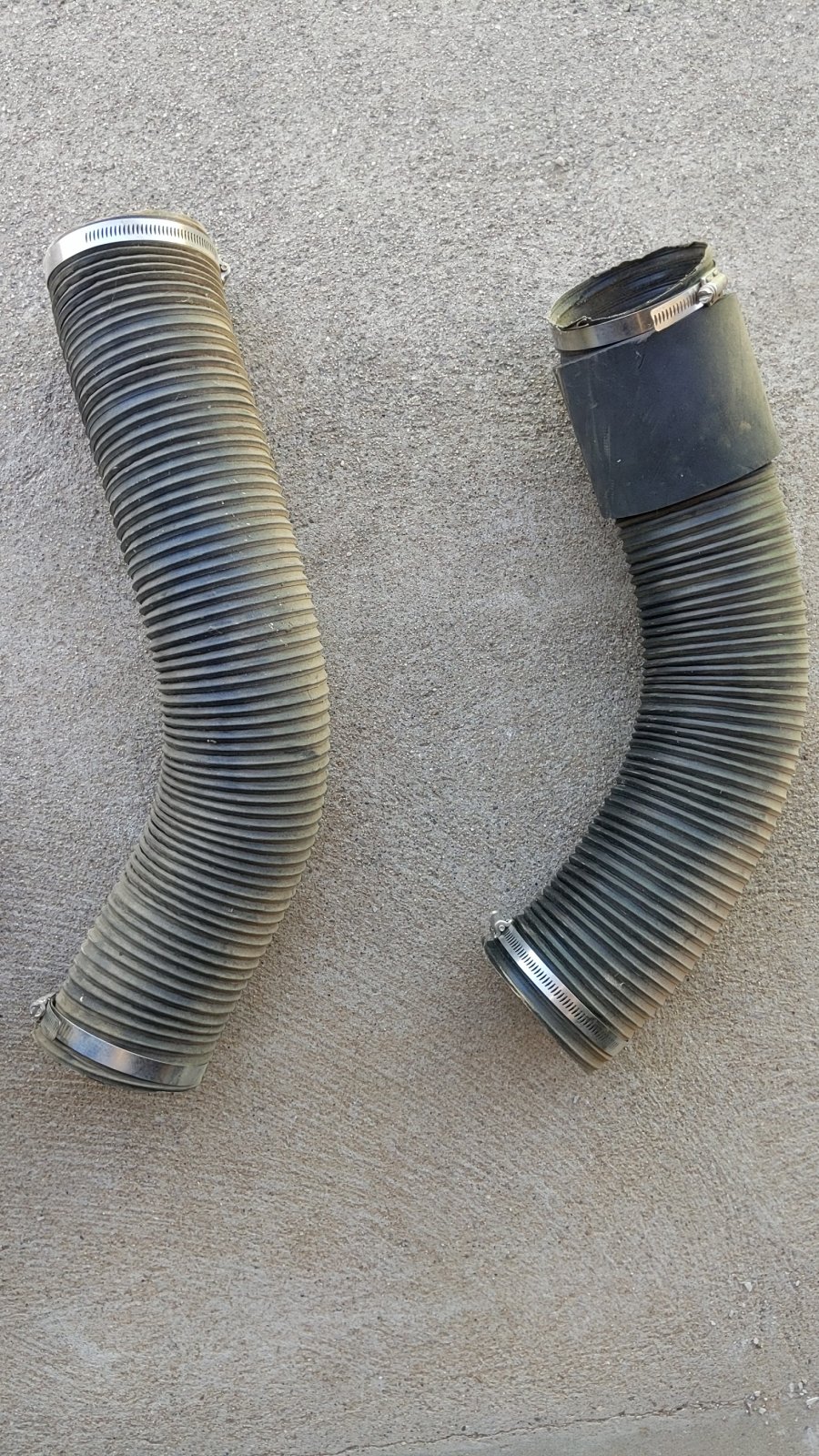

    I found a really nice looking set of heater tubes a**** Dad's stuff. So I'm going to install them. They're pretty stiff. Does anybody know of a tried-and-true method to limber them up to ease the installation? 16343233401022732770424596873070.jpg

    If they are the og "black paper" kind... not really. They were pretty fragile even when brand new. You might try heat gunning them a bit if you have one, but sneak up on it.

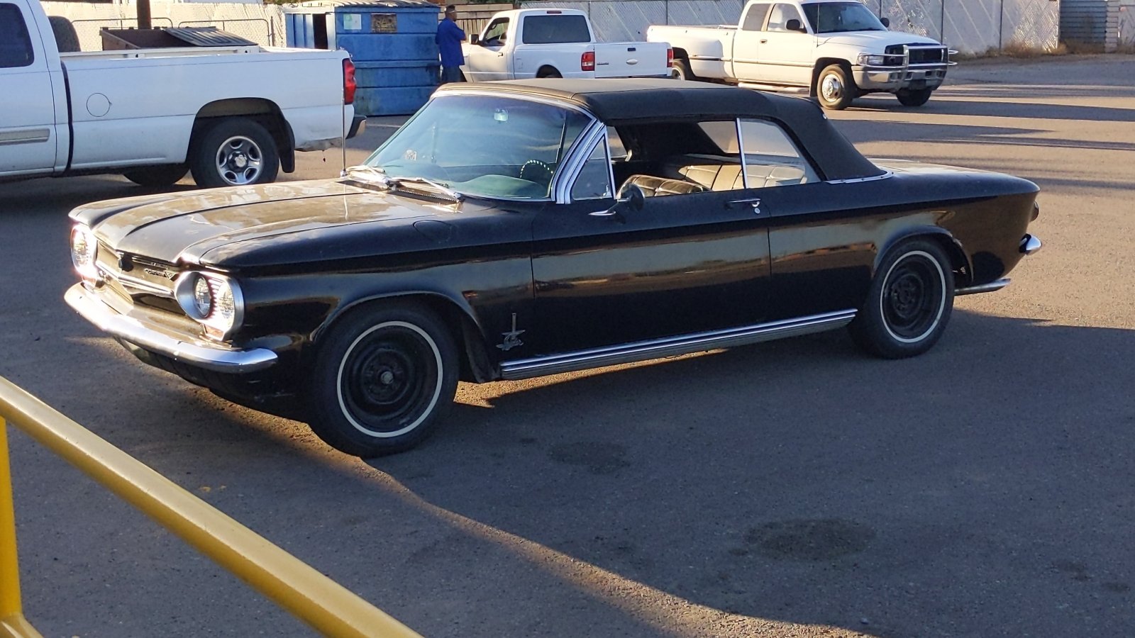

    Drove it to town to pick up some supplies and test it out. I'm actually impressed! 16343417136116480226681467641871.jpg

    why isn't the top down? It's convertible weather in Arizona this month!

    You have a good point squirrel. One thing at a time, I was just anxious to get out and get it on the road. I don't know how old and stiff the top is and how well it's going to go down but I will find out. The temp gauge started working and registered about 300° going down the road.
    The air doors opened.

    that's great! They run pretty hot compared to water cooled engines.
    Yeah, you need to be careful with the top....dont want to make any tears or holes in it before the trip!

  25. "I found a really nice looking set of heater tubes a**** Dad's stuff. So I'm going to install them. They're pretty stiff. Does anybody know of a tried-and-true method to limber them up to ease the installation?"
    I don't have a tried and true procedure but I will toss this out there ... hand cream. I have no idea exactly where those tubes go or if hand cream is flammable or not but I think I'd try adding some moisture to the paper to hopefully make it pliable/flexible. Hand cream should soak in and not drip/make a mess. Might be worth a try if nothing proven is mentioned. I have no idea what hand cream does once heated/cooked but using some might allow you to use those tubes long enough to get you home then change to fresh ones (if needed).
  26. hotrodA
    Joined: Sep 12, 2002
    Posts: 7,343
    hotrodA
    Could you not subs***ute clothes dryer or flex HVAC duct for the heater ducts?
    At least temporarlily.
    Hemi Joel, 41 GMC K-18 and loudbang like this.
