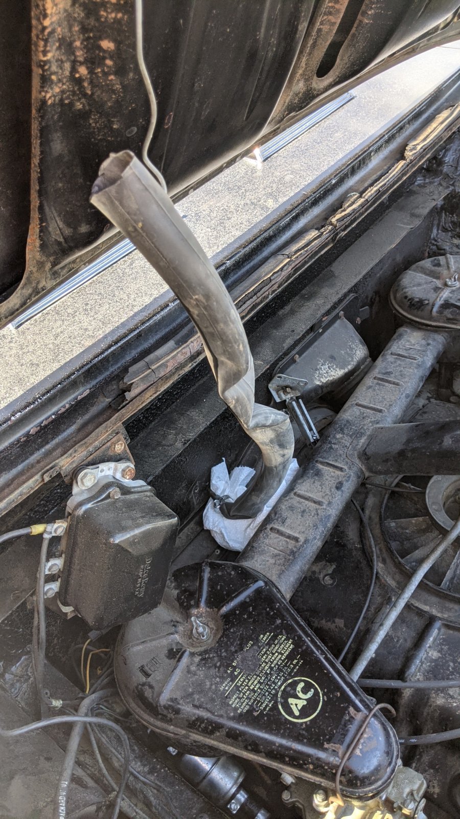

    The choke cable is really long, and it was seized up. So I used the old inner tube trick I hose clamped a piece of a bicycle inner tube to the end of the cable, and poured some kerosene in there and let it sit for a few days. That freed up the cable. Then I pulled the core out of it, and greased it as I reinserted it. It seems to work pretty good now.
