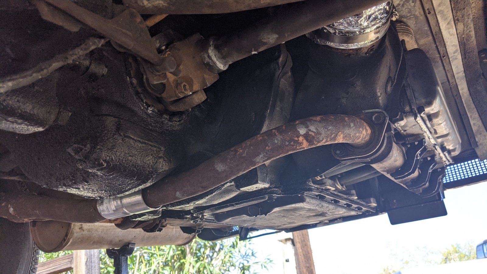

    I got the dryer tube installed for the heat ducts. That was a very difficult and annoying job because it's so hard to get my big paws up into that confined little space to install the tubing and then install the hose clamp. On the driver side I had to take the starter out to get at it. I wrapped up the terminals of the starter solenoid with duct tape, and put some duct tape around the dryer duct and tied it up with a big tie wrap to prevent a short.
    Then I installed that stock exhaust system that I had found, but when I went to install it for some reason the crossover pipe was a quarter inch too long, so I had to cut the pipe in half and go buy a sleeve and some clamps and put it back together. Then I started it up and lashed all the valves. When I was tightening the last valve cover bolt all of a sudden I heard a snap and felt the pressure on the wrench disappear. Apparently there was a helicoil in that hole that pulled out. So I tapped it out to the next oversize and put in a bigger bolt.
    I pulled the rear drums to check for any grease that may have slung out of the wheel bearings, and I did have to do a little bit of cleanup as some grease got slung out of there. I adjusted the clutch cable and the parking brake cable, then I took off this big sheet metal cover that runs the length of the center of the floor pan and lubricated the clutch cable and the shift linkage.
    Then I took it for another test drive, I went about 35 mi or so. It starts really good, runs very nice, but I could definitely tell that the rear shocks were completely shot and the rear coils are kind of sacked out. So last night I called O'Reilly's in Coolidge and they said they had one shock absorber. Then I called AutoZone and they said that they're store in Gilbert had one shock absorber. So I went to O'Reilly's and bought the one shock, and then I decided to call their store in Gilbert before I went over there to make sure they really had the shock and they did not. So now I have one shock. But the Napa store is getting another one in for me this afternoon. I also bought some of those twist in aluminum coil spring spacers I'm going to pop a couple of those in there. But the main issue is that the rear brakes seemed to be dragging making a s****ing sound and warming up the drums. So I'm going to inspect that and figure out if the handbrake is not fully releasing or if I need to back off on the adjustment or what the issue is. Then I'll put in the shocks and the coil spring spacers, clean up the interior, put the p***enger seat back in, and then it'll be ready for about a hundred mile test drive before I hit the road.
