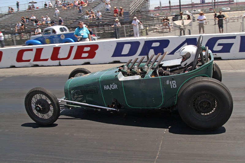

    Here're a couple shots of'er as she sits now, ready for the Grove, the Pit, and EAGLE FIELD. :D

    Love the SUs. What size are they? My Champ car will use two HS6s.

    The carbies're HIF6's (1.75") with the smog circuits deleted and blocked off. I'm running OA6 needles with red springs and ATF in the pots. The mani's Lynx, and needs the stacks to keep the standing waves in the system. I do my own porting, bought Ted Stanwood's valves, run stock springs, stock dumbell lifters, stock recessed keepers, and stock rockers (a bit lighter though ;)). These work because I only run a medium duty .450" lift Erson RDP cam (mostly for the long intake lobe). Bone stock tired short block at the moment (compressions're only in the short 100's), so only running tall 12's for now.
    She'll easily tach to destruction if you let'er, but is slow enough getting there that it's controllable.
    My next short block'll be poked .060" to .o8o", and decently balanced. That, and some decent compression'll get me to reliable mid 12's on the Coker hides.
    It may be hard for some to understand, but that's all I want out of'er.
