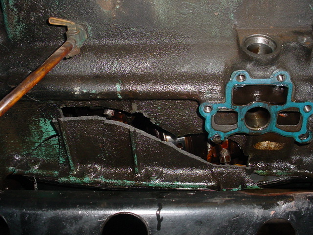

    Well, I guess it had to happen sooner or later. :(
    After 7 years I finally dropped the crank into the pan on the fifth run Saturday. Due to track set-backs we only got in 3 runs in the morning session, and due to windowing the block, only 2 in the evening session. Needless to say, Sunday was a wash for us.
    I have vids of the 5 runs (including the truncated one) but am learning a new video program, so will post'em up soon as I figure out how.
    Near as I can make it from the evidence, the crank gave it up close to the rear main, poked out the starboard side right at the pan lip level, and settled in the pan with the nose & sprocket still hanging in the timing chain, inside the untouched timing cover. That should mean that the cam & valve train'er unmolested, and the head's OK as well. Or so I'm hoping. :)
    The flywheel and rear main're still in place such that you can move the car with the starter easily, but the damper's tilted back around 10* (with the belt still in place). You get a nice view of #3 main through the window, with the angle of it suggesting the nose high attitude, but the pan lip's not bent beyond salvaging.
    No time to dig into'er 'til next week or better, but will document'er when I do. "Film at eleven.", and all that. ;)
    Looks like I'll be moving that new short block up the list a bit, eh? :rolleyes:
    Hope to have'er back among the living by ANRA II & Forever Four's Antique meet.
    Here's a shot from the field, that Sam took, along with his repair suggestion. :D

    Holy Block, Batman! Good thing you've got one waiting in the wings. Has tech at Fomoso said anything about engine diapers on the cars?

    I have the GoPro video of the "breaking" run. Everything stayed in the pan except for one piece of block sidewall which must've made the sparks on the strip that Kleet saw.
    At about 5000 in second there was a clank, a bit of vibration, then nothing. I cleared the gears & switches, and let'er roll, as there was no oil coming out. Finally drove'er off the side near the end, in case she tried to lock up at lower speed.
    James hooked me up and towed me back to the pits, then went back for Carl.
    Initially I thought I'd broken the gears, but back in the pits when we tried the start'er in gear, she moved properly. It wasn't 'til we turned'er over again and saw the balancer not moving that we put it together. Then we also noted that the balancer was tilted back about 10*, and finally spotted the #3 main through the hole, naked & down in the pan.
    Soon as I get my customers caught up I'll roll'er down to the garage, and dig into'er. I should have some details early next week.

    "I broked it." update ......
    I drove'er down to the garage on the starter motor, and started the exploratory.
    Here're some shots of the ongoing diddle.
    Looks like I lucked out on the head & valves, but the block's soul has left the building. :rolleyes:

    It looks like a few replacement parts may be needed.
  25. 64 DODGE 440
    Joined: Sep 2, 2006
    Posts: 4,432
    64 DODGE 440
    from so cal
    You're gonna need a couple more tubes of J.B. Weld to repair that. o_O
  26. Old28
    Joined: Jan 11, 2009
    Posts: 1,390
    Old28
    J B Weld - Cast Steels Best Friend :eek: Glad you are fine, blocks can be replaced, driver parts much harder. Stay safe. :cool:

    That's an interesting way to ventilate a block. I assume the piston broke when the crank dropped?
