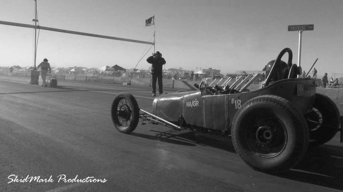

    Eagle Field 10-07-2018 005_o.jpg This shot of Skidmarks from Eagle Field sums it all up. Total time machine. Thanks for the two passes, I'll be grinning until January at the minimum and I feel like I was back in the '60s again.
    Crosley likes this.

    Wonderful event, perfect race car, great friends. Who could ask for anything more?

    That pretty well sums it up Bob.

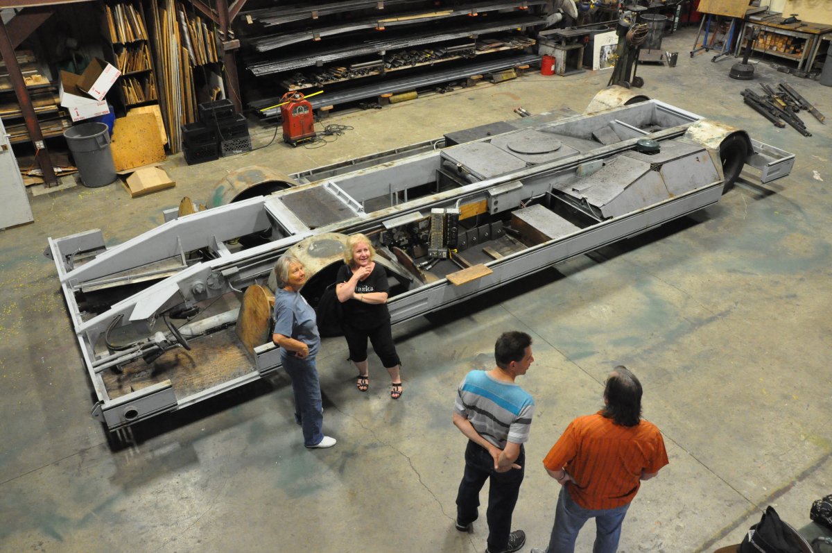

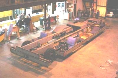

    Whilst "waitin' out the rain" (thank you Lovin' Spoonful), It occurred to me that some of you might like a peek at SMRFA's float chassis. So here 'tis ......
    As we inherited it. Wheelbase too long to make a standard street corner turn in one shot, frame too long and too tall at the ends for the smallest of the three float categories, operating crew too far aft for good vision, many mechanical problems.
    We shortened the frame 5', instituted permanent operator positions, relocated the front axle behind the operators, angled the ends down, lowered the drive engine, swapped out the Datsun A12 animation engine for a slant six, tunneled both of'em for better cooling, added "mud fenders" (read: horse manure guards) and an audio system.

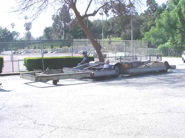

    We also made a castered extension that can be pivot attached to either end for floats in the largest of the three categories.
    Kay & I are presently working on our 20th float for Sierra Madre. Pics of the previous 19 are here, for those interested (the first four were our predecessors' designs, we were only worker bees at that point).
