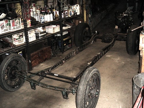

    Old6rodder
    from SoCal
    OK, step two ....... section ch***is to new wheelbase. :D
    Not too bad for an honest day's work. :cool:

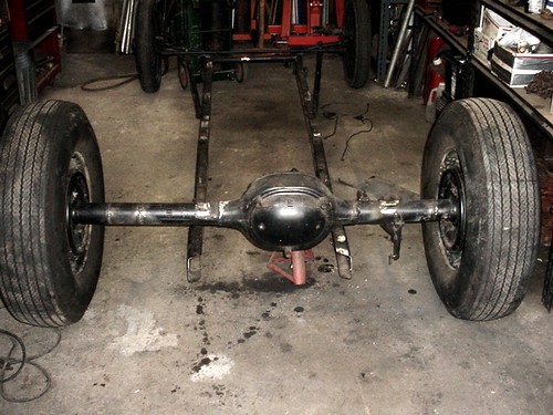

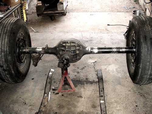

    Old6rodder
    from SoCal
    Step three ....... offset rear end.
    Swapping stock 8" Ford axles left for right results in 4 1/8" offset of pinion.
    Not as much as I'd have liked, but should be enough.
    Cost: just my labor. In other words; damn cheap. :D

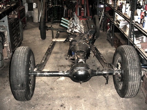

    Old6rodder
    from SoCal
    Step four ........ re-attach rails & position engine/gearbox.
    Another decent day's work. :D
    Note obligatory rodder's temporary 2x4 engine mount. :rolleyes:

    Posts: 2,376
    bobw
    I'm getting drool on my keyboard. Very clever on converting the rear end. Were you able to modify the housing at home?

    Doing the cage next, I'll be using the same seat and roll bar, but it'll be a bit more snug at the feet end. Hope to re-use same dash.
    Haven't made a decision on how the body'll be modified yet. I'll sketch up a couple possibilities, and post'em tomorrow.
    The rear end was easy, just measured the axles, marked & sawzalled the tubes (I used the wide masking tape trick to keep the cuts square), cleaned & chamfered the joints, lashed'er together & welded'er up.

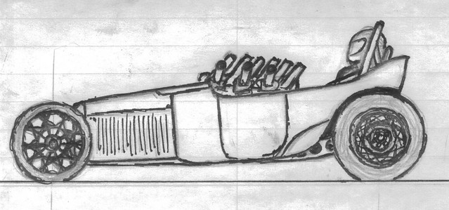

    Here's the sketch I threatened, I'm leaning toward shortening the body by removing the front doors, leaving the cowl & hood their present length. The wheelbase dropped by 21.5" (124" to 102.5"), and the doors are 20.5" wide, so that'd be about right.
    I could remove the 21.5" elsewhere, or only remove 10' or 12" (from the hood or cowl), leaving the radiator shell in front of the axle like later designs. Neither of these options presently turn my crank, but I'm open to any sketches you guys'd like to try.

    Posts: 1,390
    Old28
    That is one real fine looking sketch and the car looks proportional. Just my opinion, I like the radiator shell behind the axle as you have it in the drawing. The cowl and hood look great. I think you have the best idea in removing the front door to shorten the body. Great work and I know you have a plan in your head for were you want to go. Build it like you want it and have fun.;):)

    64 DODGE 440
    from so cal
    Looks great just how you have it drawn.

    Old6rodder
    from SoCal
    Yeah, I haven't come up with anything I like better either.
    Looks like I'll be taking your suggestion to go with a dedicated hand brake, my size 12s'd be a bit cramped trying to isolate three pedals in there now.
    Thanks for the idea. :D
    If I'm careful with the body shortening, I should ba able to avoid having to repaint the whole thing. How does just adding "Too" to the back lettering sound? :cool:

    Posts: 2,376
    bobw
    The sketch looks excellent. I had pictured you sitting a bit more forward, across from the engine. Your arrangement make much more sense.
    Do you think the driver will have to put on weight to even out the balance of the rig?:D
