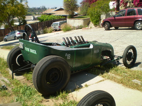

    Well Kiddies,
    I finished up the pipes, and a couple other small things. She's ready to pop the tub off, and do up the odds & ends underneath, and paint up the ch***is. I'll also fit in the front hoop while she's opened up again.
    First street test was inconclusive due to the middle carb flooding out today. You certainly do notice any sideways movement a LOT earlier now, no subtlety in'er at all. :D
    I got the trailer done, but need to put in some wheel stops. Seems taking all that length off the front of both the trailer and the car resulted in negative load on the hitch when the car's all the way back (thought it might ;)). So I'll have to park'er a bit forward of where she used to sit, and the stops'll keep me from over doing it and winding up pointed at the sky in the pits. :eek:
    Likely get'er up to Scholl Canyon scales sometime in the next couple weeks.
    Anyway, here're some pics on the street ...... :cool:

  10. bobw
    Joined: Mar 24, 2006
    Posts: 2,376
    bobw
    I know it's an overused term, but...your car looks awesome! Being on the street gives scale to the pics.

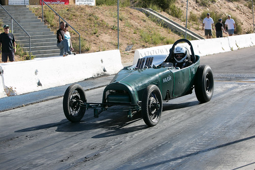

    Howdy Gentlemen,
    Well, I had a blast at Barona again. :D
    Got in 6 runs, three of'em with the 'Doll (two with Dimitri, and one with Amy). Could've easily done more but they run the tow-ups in a specific lane, and we had to sit out the lane rotation each time we ran together.
    Met some decent kids with some cool old putts, and a whole A/FX club (with a dozen cars there racing). Pete Liebig, the track's photographer, took several pictures of the 'Brick, including some with the 'Doll, and a couple "artsy" ones. :cool:
    So I bought this one ...... :D

  27. OBFB HA/GR
    Joined: Jun 2, 2008
    Posts: 455
    OBFB HA/GR
    So how does the times go with the new combo?
  28. bobw
    Posts: 2,376
    bobw
    Now where's that "envy" icon?:)
    Did everything check out after the major reconstruction? Great that Barona lets you run and doesn't panic seeing a side-by-side machine.
