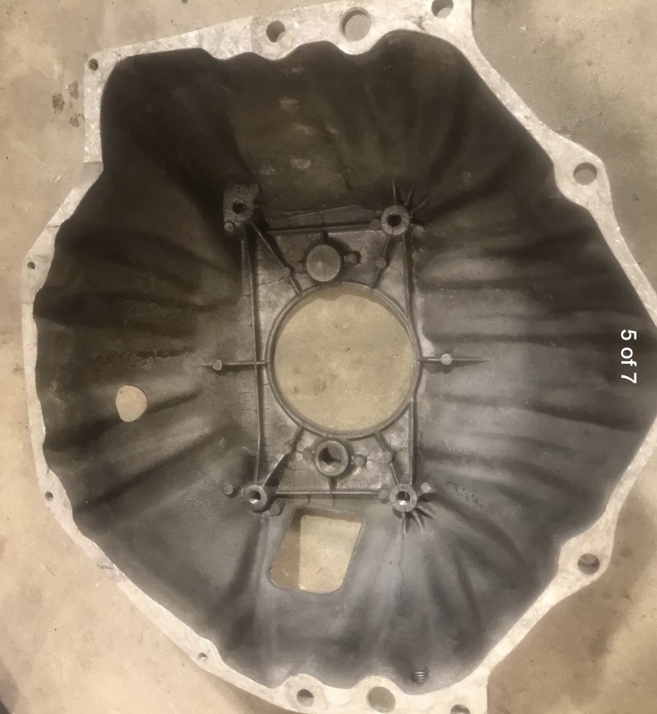

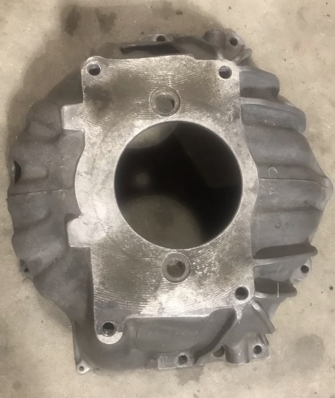

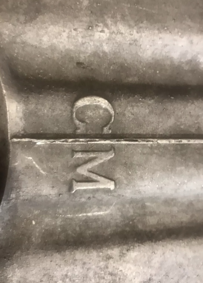

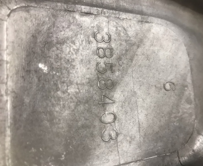

    I can’t upload a pic of my bell housing but it is an aluminum one with casting number 3858403 casted into it. No idea where it came from but has typical SBC to sm465 flanges at their respective ends. Next thing I’ll need to find is a clutch fork haha

    Dang, can’t beat $43 with a stick! I looked up the bellhousing number and it says it won’t work with a sm465, 4.65” bore vs 5.125” bore, but I can hog out some aluminum fast with the big lathe at work so that’s not a worry. Everything I’m seeing though says this aluminum bellhousing only fits a 153T flywheel and a 10.5” clutch, any suggestions for me for clutch that is 10.5” with a 10 spline center? Thanks!

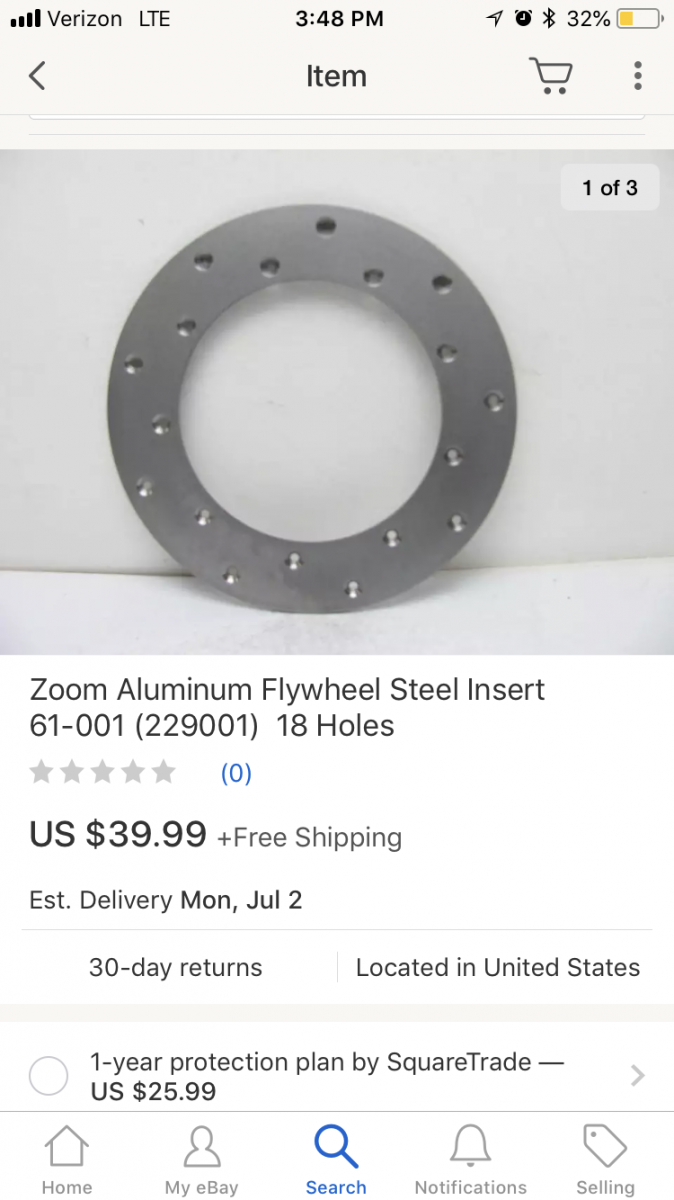

    I just bought an aluminum Chevvy flywheel at a swap meet, too cheap to p*** up ($15). What seemed strange to me was that it did not have a steel insert plate at the clutch disc wear surface. A friend, much smarter than me, told me it was probably from a marine engine, which, lacking the inertia provided by the torque converter, needs a flywheel much heftier than a flex plate. Does anyone know if it is feasible to bolt a steel plate between the pressure plate and flywheel? Does anyone market such a thing? Or can the flywheel surface be machined in the clutch disc area, and a steel disc be attached as done on commercially available flywheels? Or should I just relegate it to being a cheap wall-hanger?

    Only $39 on eBay for the insert
