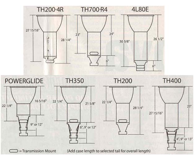

You'll probably like the 350 much better. My experience with powerglides is they're good for around town, but having an extra gear will help on the highway. here's a chart showing size comparison. Looks like you'll have to shorten your drive shaft. But your transmission mount point is the same.

As stated, a PG to 350 swap is almost a bolt in. The shifter linkage will need work and a new input yoke is required. The 350 is about 3/4" longer than the PG. You "can" use the driveshaft the way it is, but there's a chance it could bottom out and damage the rear seal causing a small leak. On the street, the 350 is a huge improvement over the PG. You wont be disappointed..... But if you really want to get fancy, you could go for a 200r4 swap. The 200 has 4 forward gears, a lower first, and an overdrive, along with a lockup converter. While a 200 swap would be more expensive, it could pay for itself in fuel savings if you drive the car a lot.
