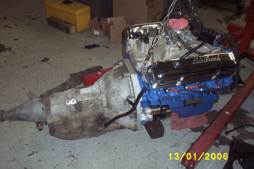

  4. Great idea, but as mentioned, expensive.
    See adaptor below-

    cool were can i get one of those adapters and what about the drive shaft i have the original one what would i have o do to it lets say if i am using the tranny thats in the picture what is that that gm tranny.:D
  6. That is a FORD AOD shown. I do not speak GM, MOPAR or ASIAN/EUROPEAN.
    http://www.transmissionadapters.com/ford_fe.htm
