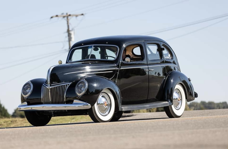

    FB_IMG_1664895700263.jpeg Unless the 39 box is plumb wore out, no need to change. Unless you want that overdrive 5th.
    I’d run 70-75 all day long with a 39 box and 3.78s. With 750 16s I’d guess that 305 Chevy was turning 2800 ish.
    unless you’re going racing really no need to make a switch.
    And was said before, the 39 box has that old car feel. Anymore if they’re too modernized it kills their soul so to speak.
