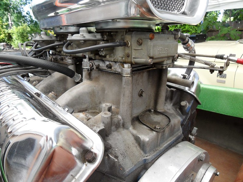

    Can those secondary's work hooked up like that?
  3. Choptop
    Joined: Jun 19, 2001
    Posts: 3,303
    Choptop
    no. They are blocked off intentionally by the previous owner. One of the things I need to fix.... he said with the secondaries working all it did was burn more gas, didnt go any faster...

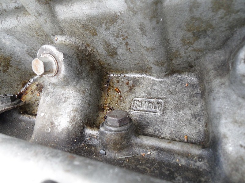

    P.S. no casting #'s on the intake.

    I'm no guru, but it looks as if those carbs are sitting pretty high up to be a piece that came stock on a car, may be something that was sold across the counter as a hi-po part. No dates cast near the T-stat housing? The list numbers on the carb air horn would be helpful as well.
    If Mean Gene checks in, he'll probably be helpful.
    Looks as if it will get that boat movin'!
  6. 53 effie
    Joined: Oct 21, 2004
    Posts: 254
    53 effie
    Just my opinion, but that manifold looks to be a Medium Riser and maybe an "over the counter" item. The Medium Riser came originally on 427 Fairlanes and Comets in 1966 and 1967. Also on the big block Shelby in 1967 but those had C7ZX part number cast into them.
    I've heard the Fairlane manifolds came without the casting number and the ones sold by the Ford parts counter didn't have a part number on them either, just the "FoMoCo" that you show.
    The Medium Riser manifold is quite high in the rear like that - from the carb baseplate down to the block off plate. I had both a Low-Riser and a Medium Riser 2x4 manifold side by side once and there was quite a difference in manifold height.

    It is a 65 up no casting number Medium riser intake. They where sold over the counter and came on the 67 Fairlanes and Comets. Does it have a date code anywhere? Maybe around the T stat housing? What head casting numbers are on the motor? thanks Lance.

    As others have said its a medium Riser 427 dual plane.
    What carbs are they? 66~67 comets and fairlanes in 66-67 would have had
    Holley List: 3300 & 3301 or BC/BD carbs
    If it is above carbs it is a very desirable package. The Shelby's had BJ/BK carbs along with low riser 427's
    The hoses are hooked up to a vacuum port but should be just a single hose going from one carb to the other
    same as on my '67 427 Capri (factory R code)

    Ya think? Yeah, never seen anyone hook the vac balance fitting back to that vac port like that- all it is is a line between the two pots to balance the vacuum between them to hopefully get them to open at the same time. Usually those carbs work pretty well in stock condition, and the more they have been messed with by shade tree guys, the worse they run. This is what that intake looks like with 2" spacers under the carbs

    I'm no expert but it looks like a factory Ford 2x4 FE Medium or Hi-riser to me. Definitely not a Lo-riser. Did some googling and could be a 428 Shelby GT500. http://mustangtek.com/FordIntake.html
  15. Kentuckian
    Joined: Nov 26, 2008
    Posts: 879
    Kentuckian
    The reason the height is staggered is because of the angle the engine sat in the original Ford cars. Since the engine in a Ford was tilted down in the rear, the angle allowed the carbs to sit level.

    any tips on where/how the 2ndaries vacuum lines should be hooked up? Where does one pic up vacuum on this manifold? I'm guessing where the PCV valve is now, just with some sort of "T" to allow the vacuum advance and 2nd's to get some as well?

    Not a High Riser, it is a Medium Riser like others have said. It doesn't look like factory carbs but we'd need to see the numbers for that. The vacuum pots with the lump on the top are later. They are the ones i used to convert a pair of 3310's to my High Riser.

    This old TSB from the 427 Galaxie site shows the factory correct configuration for a low-riser set-up. Go to Page 7, I think.
    The factory low riser carbs did not have a vacuum port drilled because the dist. did not have vacuum advance. Or so I have been told.
    Hope it helps, lots of good info here:
    http://www.427galaxieregistry.com/1964tsb.html
