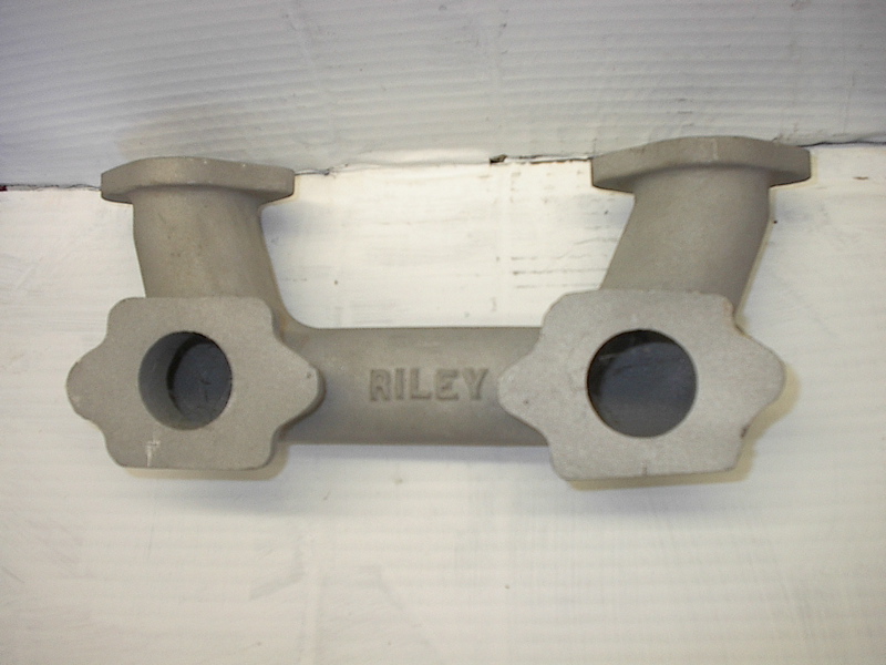

  15. Would really like to run the Winfields. So if anyone has an intake like the one in this photo I am interested.
  16. I have some castings that were made from original Riley patterns that can be modified to fit A or B block This is not an advertisement, it is just information.

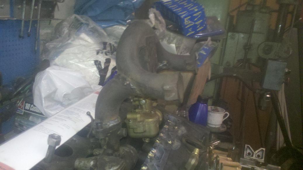

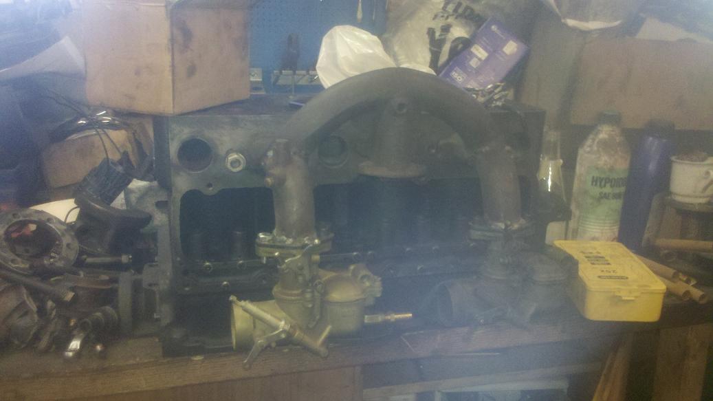

    I have this junky B that was used in a boat. It's rusted thin and has a big crack in front and missing a piece of the water. But I thought it might be fixable. Since I'm drilling all my cranks now I took it apart to get the crank out. found out it has cracks around the valve guides so it is junk for sure. Tha crank was pretty bad too. But there was a pleasent surprise. I nevere really looked at it before but when I started removing the oil pan I noticed it was differnt from a normal B. It's a cast aluminium pan. I've heard rumors about them but never seen one and I actually had one myself. Here's some pics of it next to a G28T pan. It has some repairs, but pretty decent anyway. I think I'll polish it..... then paint it flat black and use it. No not really. I spent some time building an intake too.
    Just Plain Bill >> Could you tell me more about the Riley intake? What needs to be done to make it fit an A/B? Does it have the correct port spacing? ANd for the record, I'm also interested in a dual Winfield intake. Think the look so damn cool. I have one of the Dan Price intakes for dual 2 barrels, but the 1 barrel version just have the look.

    Do you have any better pics of this intake?

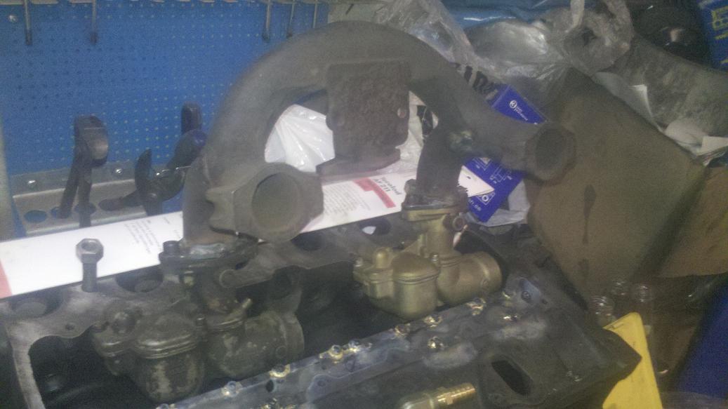

    Sorry, I've busted the lens on my camera. But I tried to get some better pics.
    The carbs sits pretty far out to the right. But I think it looks kind of cool.

  28. I remember Dan Price single down drafts for Winfield but not duals. I bought Miller dual Stromberg downdraft from Kiwi quick change. If, at that time, I could have found a dual downdraft manifold for Winfield's I wouldn't have gone to the trouble of locating the patterns and having some cast. I only wanted one.
    These manifolds were designed for the original 2 port Riley B head, each head size had a manifold sized for it. The B size manifold has, if I remember correctly, 1 5/8" ports and apparently was sized for Winfield BB's although there is quite a bit of extra material on the carb flanges. The important difference is the mounting hole spacing. The original Riley has the mounting holes closer together than the A or B. The original Riley use 3/8" size bolts or studs. I have machined one to fit the A or B block and had planned to use 7/16" Allen nuts rather than clear it for regular nuts. I also figured out a linkage to work with the stock A, actually a way or place to mount a boss to hold a pivot. I use the term "original" Riley because I understand Mr Yapp uses stock AB spacing for attaching the Scalded Dog and other aftermarket manifolds to the C Yapp Riley 2 port head.
    I do fabricate my side draft manifolds as well as my side draft adapters.

    Bill I stand corrected then I think the manifolds manufactured here are for the A/B bolt pattern thanks for pointing that out. Rusty
