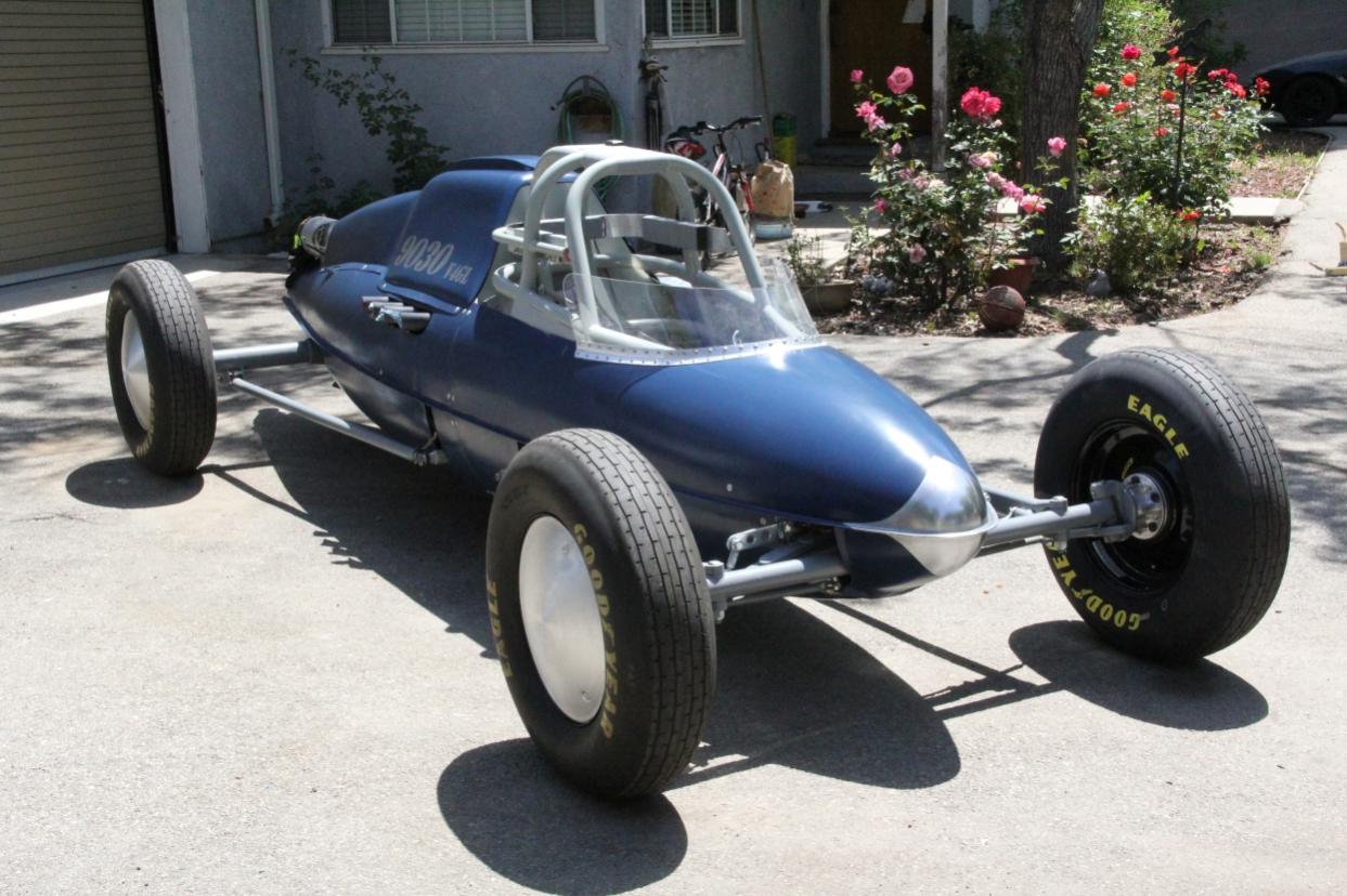

  4. Latest pic.
    So this is not your everyday roadster.
    It is powered by a Model B block and valves overhead.
    John

    Looks like a fun ride.

    John,
    That looks like a kick in the pants. Can I get a ride in it?:D
    What are you using for a trans?

    of course you can go for a ride if I can borrow your hot rod.......
    the trans is a modified sprint car from east coast car
    John

    That sounds like a good trade ....... week end for week end?
    So is the trans just an in out box?
  17. Dan,
    no, the trans is two speed.
    It has a small clutch internal to engage the 1st gear and high gear is straight through like a I/O box. The intention was to push off from starting line and just use 1st to pull away from truck, in testing though, I can start from dead stop and accelerate.
    Probably the saving grace is that gearbox was designed for 7-800 HP, just a little bit more than the Banger can produce.
    As for weekends, no problem, you won't like the fuel in the tank, about 1 gallon of 114 octane for about 2 miles. But it smells soooooooo goooood.
    John
