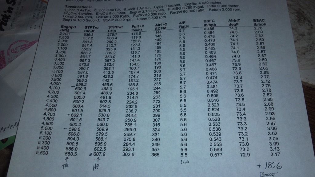

    So on the dyno I ***ume the afr's were all looking good during the pulls (like in the mid 12's)? It just seems to me like even a very mild sbc as yours with 6psi or roots blower stuffing through it ought to move an altered coupe as yours very well with a manual ****** and 4:11's. The rpm range sounds like an "rv" cam. Perhaps just a tad better than a stock general purpose sbc cam with a power curve meant more for improved torque rather than hp. A blower grind will help but it isn't necessary. You do want to try to increase lift while not adding too much overlap (the boost blows right on out the open exhaust valve) so keep the centerline 110* or higher. SBC's really start knocking down some impressive numbers when the heads are in the 300 cfm area and higher and the cam lifts surp*** .600. Your heads would need so much work to approach that it'd be more cost effective to swap them out (I'd recommend AFR if you do). Increase the cam lift too much on your current heads and the guides and seats need machining with the new, stiffer, compatible springs.
    For an inexpensive alternative I might install an Edelbrock Performer RPM cam/lifter/spring combo. While not specifically a blower grind, the spec's will work nicely and it'll rpm much better. Good lift for a stock headed sbc favoring the exhaust side, tight lobe centerline, broad power range with a ceiling of 6,500rpm. These camshafts increase power nicely in factory type, cast iron headed sbc's. Noticeable lope but not bouncing the doors off the pavement at an intersection.

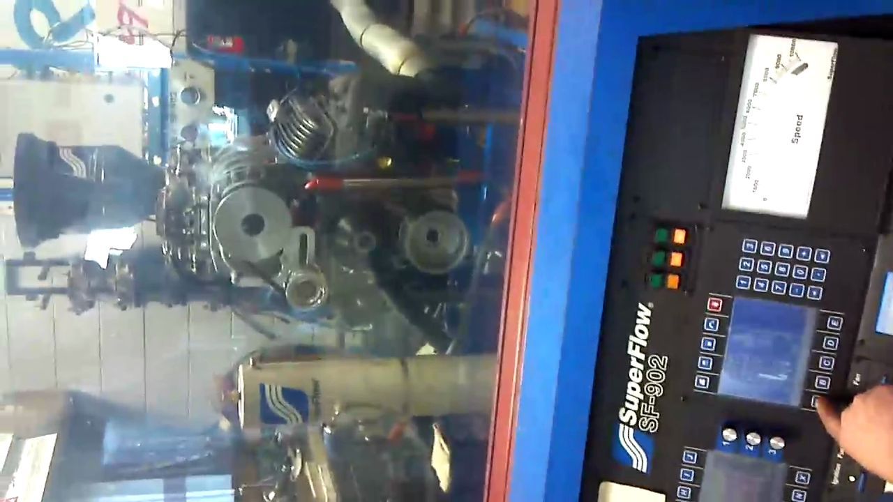

    how much boost....way to much... 1:1 was 18! underdriven by 18% was tolerable at 15, but that's on a dyno, not what's seen day to day. Compression is 9.2 if i remember correctly.
    Ok, i'm not really good with a camera....
    click on the small pic
