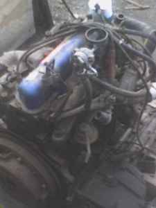

  11. Please help ID. A guy has a Pinto engine but doesn't know what year it came out of, or what size it is, can't take and email more pics, and this is a couple hours drive away.
    Is it a 2.0? I'm looking at the front of the valve cover and it doesn't look like a 2.3, but I've got turbo 2.3 valve covers ...

    That is a 1.6L (98 cu in) "Kent" engine that came in 71-73 Pinto's, and Capri's (they were originally in cars like Cortina's in England). The cam is in the block so it's a totally different engine than the 2.0 EAO, and 2.0-2.5 Lima engines. Parts for those are really hard to find now days.

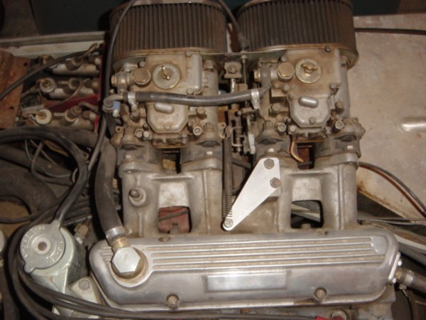

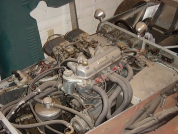

    Here is a pic of one of mine.
    Twin Webers, dry sump, finned valve cover, etc...

  22. metalshapes
    Joined: Nov 18, 2002
    Posts: 11,130
    metalshapes
    A mid '60s Mallock U2 Mk6.
