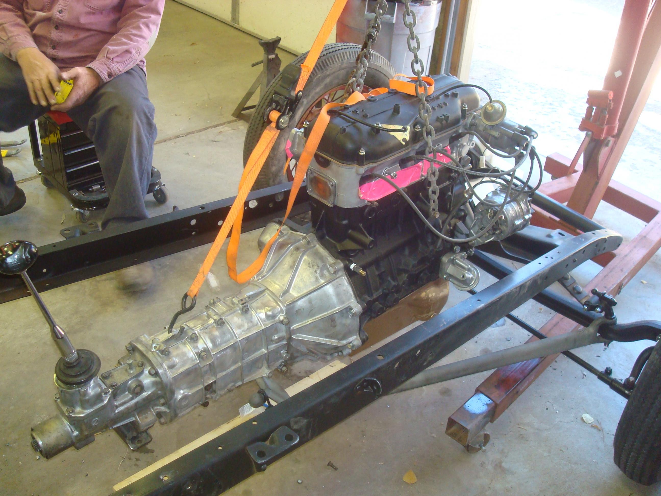

    I know that 1.8 SOHC engines are the red headed step child on this form, but thought you might like to see this project we started today. engine has domed pistons, new Crower cam, balanced, lightened flywheel, modified pan and twin 40 DCOE Webers.
  18. gnichols
    Joined: Mar 6, 2008
    Posts: 11,412
    gnichols
    from Tampa, FL
    Interesting looking mill. What vehicles had these? Gary
  19. denis4x4
    Joined: Apr 23, 2005
    Posts: 4,394
    denis4x4
    from Colorado
    This one came out of a '75 Ford Courier. Same as the Mazda pickup of that year. Body will be a 'gl*** '31 Deluxe Sedan Delivery. Same WB as the Courier and considerably lighter than a Model A of the same vintage.
