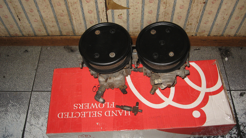

    hi I JUST PUT THIS UP ON THE general discussion page and figured that this might be better please help me ID this 4 cylinder intake with dual holley/weber carbs thanks Bruce,

    Never seen an intake like that for the Fords.

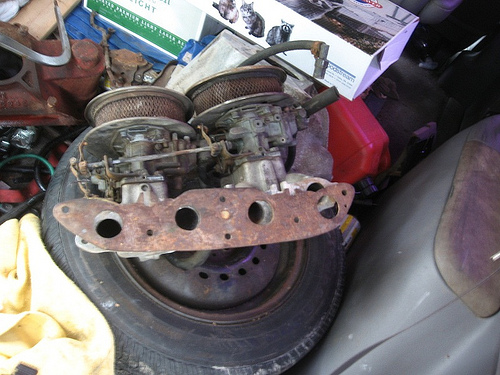

    [Never seen an intake like that for the Fords.] looks like a 2.0 early pinto gasket to me but I don't have any gaskets laying around,this is a 3 piece unit with 2 aluminum castings each containing 2 ports and 1-2bb carb plus a steel plate that they bolt to and everything bolts to the head, I may order a gasket to try and figure this out.I've looked all over the internet looking for some thing like it, thanks for your efforts

    2.0 Pinto/Capri intake manifold.
    Looks like it's for a 2.0 except for the extra 2 upper bolts, I've seen a dual 1bbl intake for a 2.0, but that one is the first one I've ever seen that's for dual 2bbl downdraft Webers.

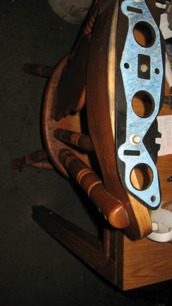

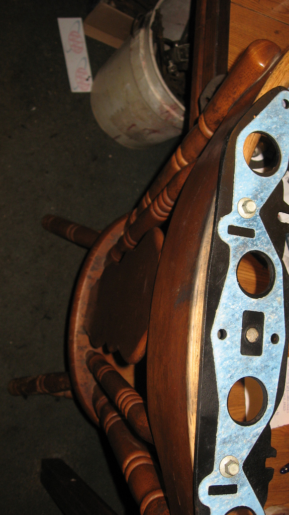

    thus looks like it is for a early 2.0 pinto motor here are some pics

    Somebody cut, and modified two stock 2.0 intakes, pretty ingenious.
  18. a4278v
    Joined: Dec 12, 2005
    Posts: 2,447
    a4278v
    yes I'm sure that is what it is,pretty ingenious for sure

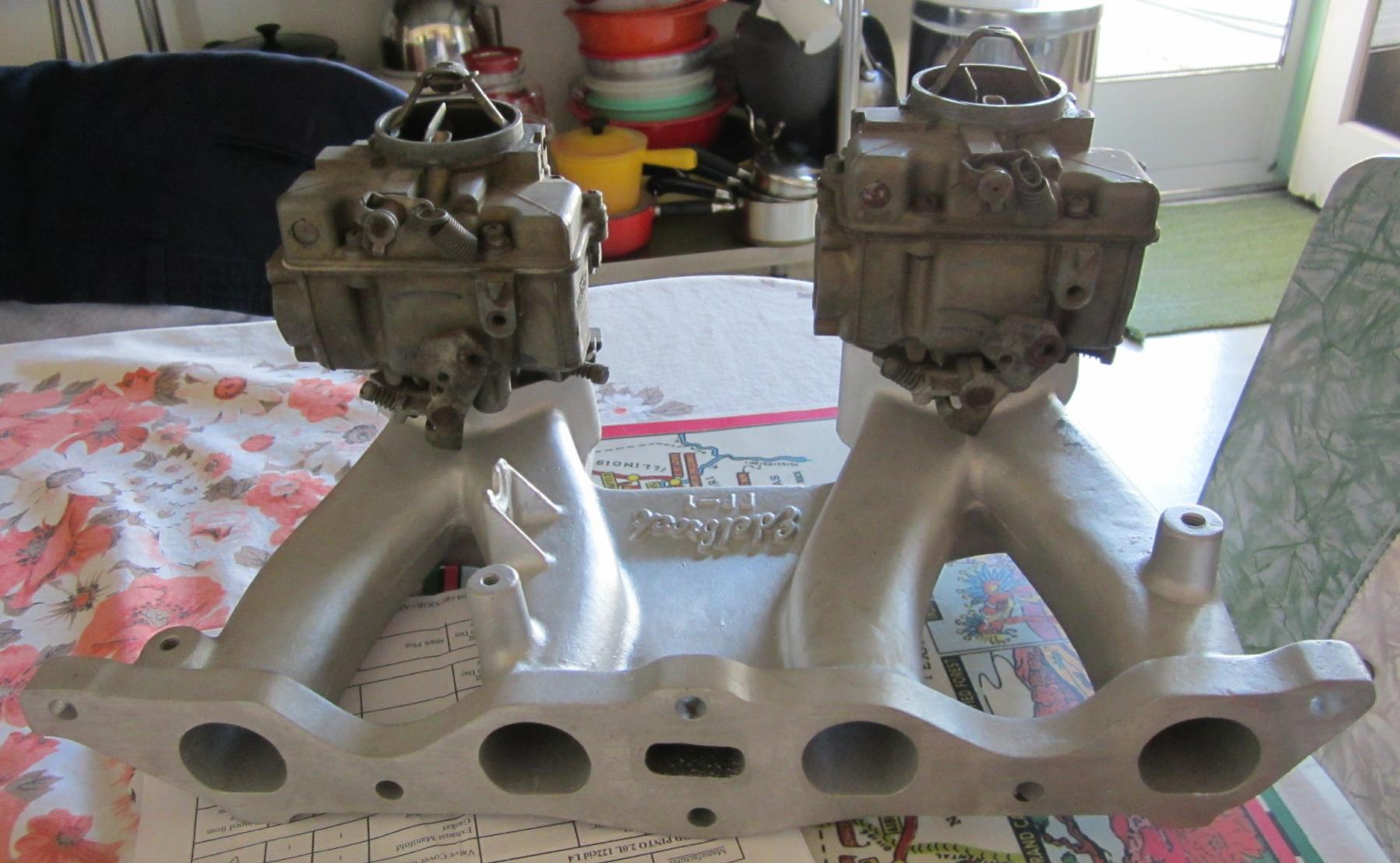

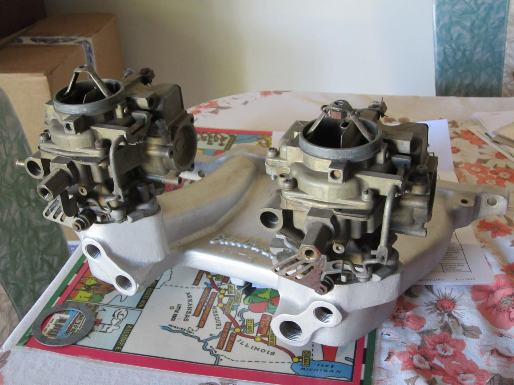

  23. Great thread and of course timely.
    I just bought this for the 2.0 in my '28 Tudor. I found out from carbking that the holleys were made for edelbrock and kits are long gone. I was thinking of using some carter YF's (thanks again carbking).

    The carters should work.
  25. The carbs are based on a holley 1940 it looks like. I took one apart and bought a hygrade 540 kit, so I'll see if the kit is a match. I also found 2 1940's and 2 carter YF's for $5 at a swapmeet (1 YF is a parts carb.).
